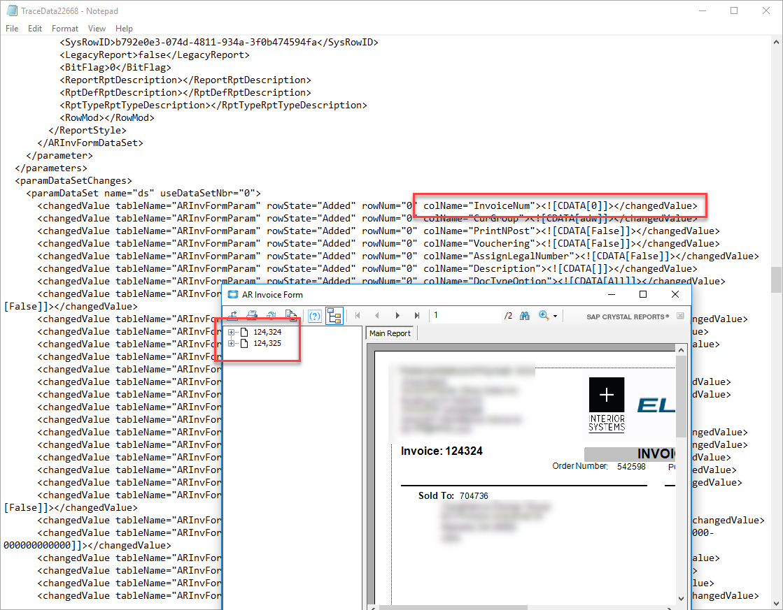

I did a trace on the Mass Print AR Invoices report (Financial > AR > Reports)
and it looks like with that you have to at least past a list of CustNums and a start/end invoice number:
<parameter name="ds" type="Erp.Rpt.ARInvFormDataSet">
  <ARInvFormDataSet xmlns="http://www.epicor.com/Ice/300/Rpt/ARInvForm/ARInvForm">
    <ARInvFormParam>
      <InvoiceNum>0</InvoiceNum>
      <CurGroup></CurGroup>
      <PrintNPost>false</PrintNPost>
      <Vouchering>false</Vouchering>
      <AssignLegalNumber>false</AssignLegalNumber>
      <Description></Description>
      <DocTypeOption>All</DocTypeOption>
      <EnableAssignLegalNumber>false</EnableAssignLegalNumber>
      <PrintStatusOption>All</PrintStatusOption>
      <TranDocTypeID></TranDocTypeID>
      <TransOptions>ARC</TransOptions>
      <CustList>3~52~4~831~725~5~6~7~8~933~9~12~14~842~541~64~564~565~721~566~567~568</CustList>
      <DCList></DCList>
      <TH_IsService>false</TH_IsService>
      <ARInvFormReportID></ARInvFormReportID>
      <BeginNum>15061</BeginNum>
      <EndNum>15070</EndNum>
      <InvoiceStatusOption>A</InvoiceStatusOption>
      <THHeadOfficeOrBranch></THHeadOfficeOrBranch>
      <THPlaceOfBusiness></THPlaceOfBusiness>

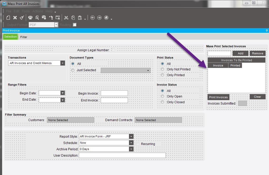

I leveraged the native EpiDataView “ReportParam” inside Mass Print AR Invoices to submit each invoice number in the list to the task agent quickly. The only problem I’ve had with this approach is that if they are submitted too quickly, there has been instances where the report header does not match the report details, resulting in some really wonky invoices. To solve, I put added Thread.Sleep(500) inside my foreach loop and that has served me well.

Rpt.ARInvForm.ARInvForm_Customization_MassPrintSelectInvoice_CustomExport.xml (40.8 KB)

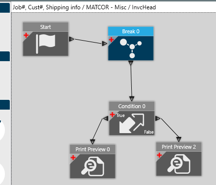

If you have APM - you could create a Break Routing, and break on UD field added to the InvcHead table. That UD field would be updated by a dashboard used to select the invoices to print. A Condition widget in the Break/Routing could be used to filter out the invoices you didn’t select
Then in the BPM’s autoprint widget set:
  • the CustList, as all the CustNums (ex: "1~33~5661~4490")
  • the BeginNum to the MIN of invoices selected.
  • the EndNum to the MAX of invoices selected.
While the above selects any invoice in the range BeginNum to EndNum AND with the custnum in the CustList,(which includes Invoice you don’t want), the break rout would break it into different printjobs based on the UD filed. And a condition widget could throw away the ones not to be printed.
The following makes one print task,
but generates two separate reports.
Changing the widget connected to the FALSE output of the condition, to a Gen only shows that the “unselected” were only generated and not printed.
Have nothing connected to the FALSE, and you’ll only get the invoices you selected.
And if you don’t want to update the InvcHead table with a UD field. Use a UD table to hold the desired invoice numbers. Then add it to the ARForm RDD, with a definition relationsship.
And that shouldn’t even need the Break Routing. The RDD output should be limited to the invoices in the UD table.

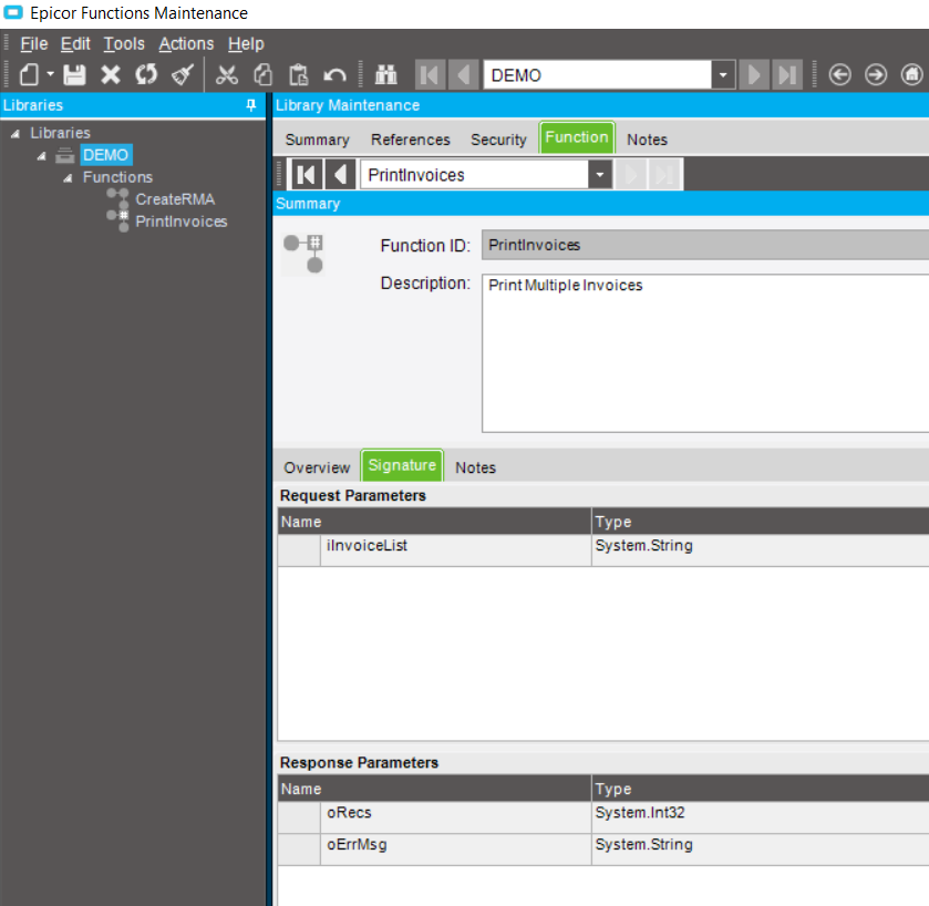

Sooooo, have I ever mentioned Epicor Functions? :slight_smile:

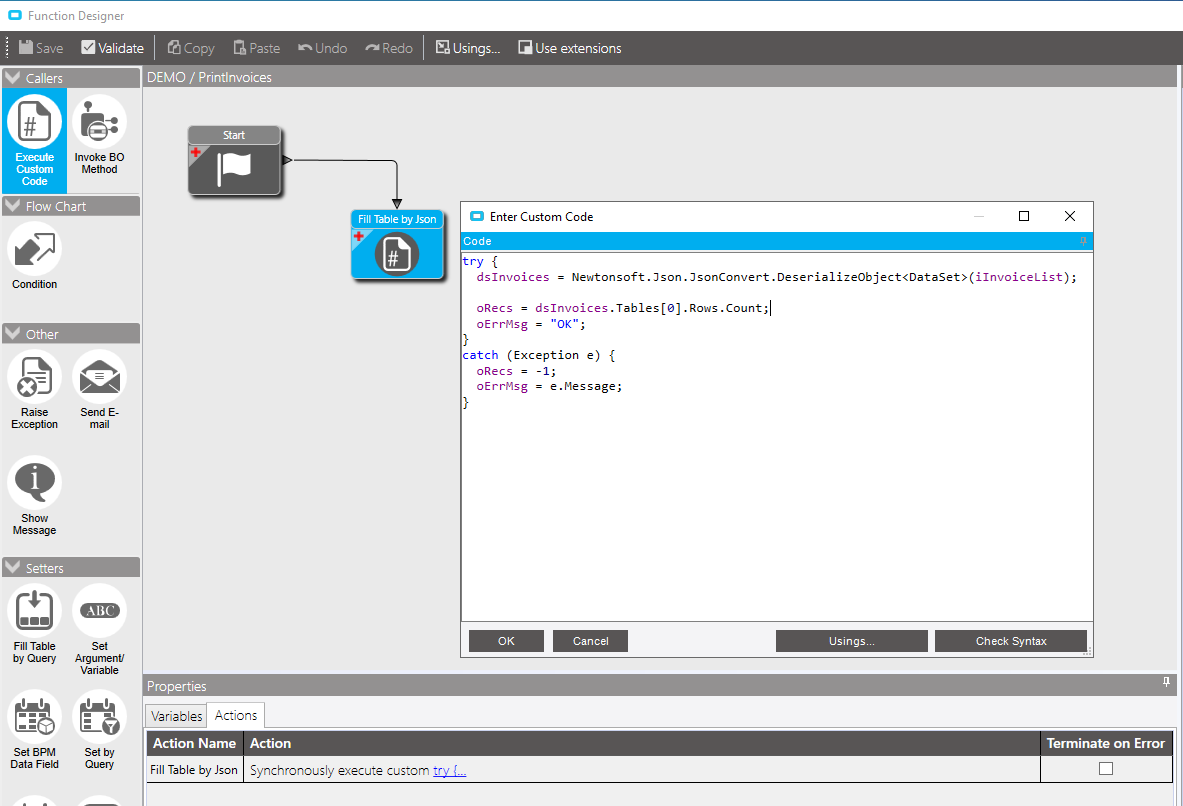

Create a function that accepts a json string in a dataset format. Something like:
  "Invoices": [
      "id": 100000
      "id": 100001
Add a Reference to Newtonsoft.Json.
Create a function that accepts the Json string.
Make sure to add a using for the Newtonsoft library:
Declare a DataSet variable to hold your invoices:
Add the one line of code that deserializes your Json into the DataSet variable.
Now you have your invoice numbers in the dataset, so you can use @Aaron_Moreng’s code to do the actual printing.
