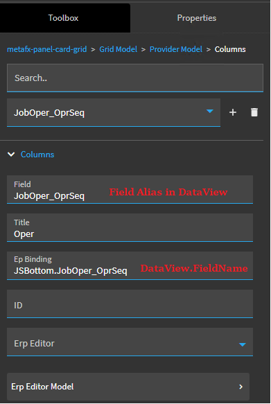

When attempting this, I have added all of the columns to the provider model with the following info:

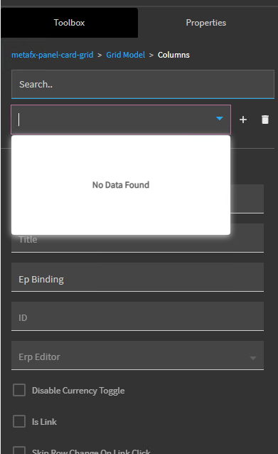

I then go into the Data > Grid Model > Columns and this is what I see:
I tried adding the fields to the column list in here, but, it did not yield any results.

I wouldn’t worry about the columns in the Provider Model–I’ve never had a need to use those.
Add them to Data > Grid Model > Columns, same as you have set in your screenshot, but leave off the Ep Binding property.
