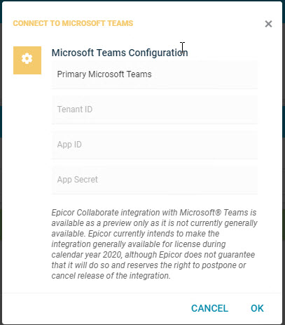

Thank you Brett, this is not what I’m looking for. I’m trying to save the connection setup to Microsoft Teams in the following window, but it doesn’t save. Am I doing it wrong, maybe? This is why I’m asking if it worked for some of you.

@Alexandre_Pothier, Epicor Collaborate integration with Microsoft Teams enables two-way synchronisation between a Collaborate group and a specific Microsoft teams channel.
For this to work with Microsoft Teams, you need Teams to be linked to Azure AD (as an Enterprise Application) and for Collaborate to be registered as an application within the same directory. This allows all the necessary permisisons for the two to communicate with one another to be set.
Since 10.2.600 (that all these features require) is not GA at the time of writing, I suggest you reach out to your account manager for the documentation on setting this integration up. It is a one time process in Azure AD that will unlock new possibilities for collaboration that I am certain you will find most exciting.

Thanks for your help. I’ll be patiently waiting for the documentation to come out, but I feel like my issue is that I haven’t registered Collaborate in Azure AD. I’ll give it a try. Thanks again.
