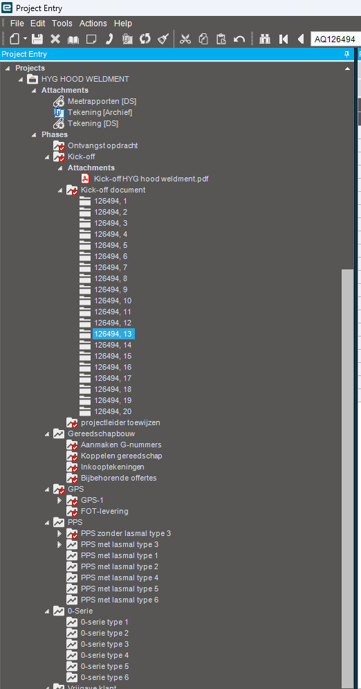

Upon opening a project in project entry the tree with phases, milestones etc. is expanded. This is making it way too cluttered so we always collapse everything before working on the project. Is there a way to have it collapsed upon opening the project by default (preferably via standard settings)?
The way it opens (as you can see, we use a classic form for project entry still):
