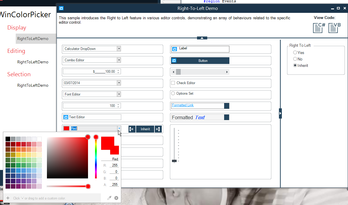

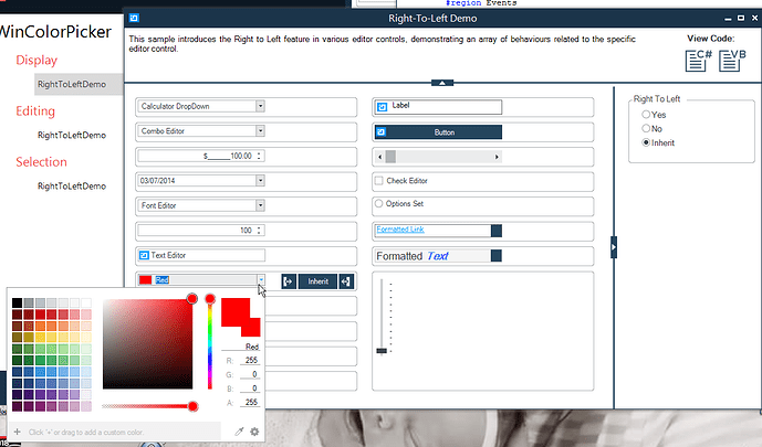

I just downloaded this windows form sample from infragistics (from the link already posted). It’s a pretty cool program that shows you the controls and then gives you a way to view the code. The color picker is one of them. Now I just have to see if I can figure out how it works, and if I can get this into epicor. (I’m kind of guessing no, but we’ll see I guess)
