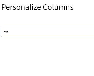

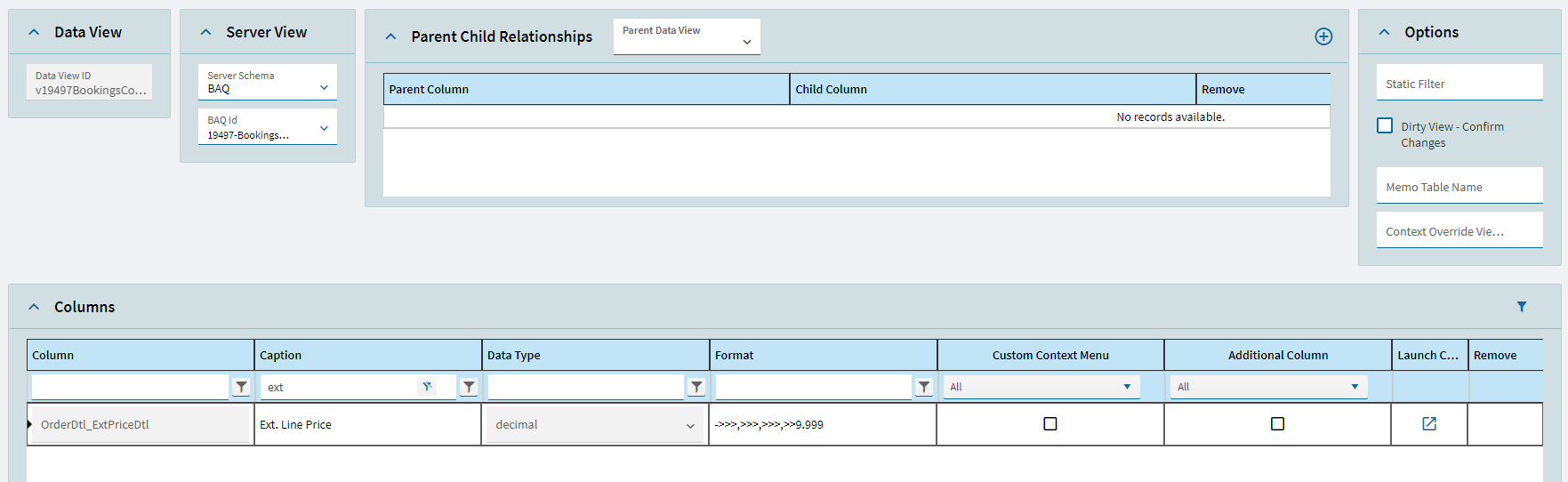

I have a dashboard that I’m converting from Classic that is not showing two particular columns (OrderDtl.ExtPriceDtl & OrderDtl.Discount) in the grid nor in the “Personalize Columns” panel, but they are in the data view and not hidden. I can see them in the grid model > columns, but they do not show in the grid. I can check the “hidden” box in Grid Model > Columns and then uncheck it to see the columns in Application Studio. However, when I preview the screen they appear in the active card, but as soon as I move off that card to another then the two columns have disappeared from all cards, including the one they were initially showing in.
I’ve tried by converting the old dashboard (making some layout changes to the cards in application studio) and by building it new from scratch. I’ve got six different BAQs in this dashboard that all include these fields and every single one of the grids is having this same exact issue.

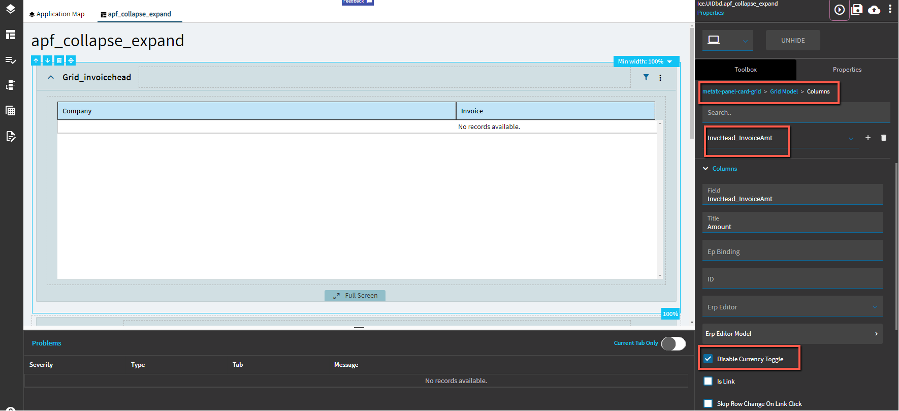

Support has provided another workaround for this problem. In App Studio grid properties > Data > Grid model > Columns, select the missing column and check “Disable Currency Toggle.”
Still waiting for Development to call this a bug though, because the columns should not be missing in the first place.

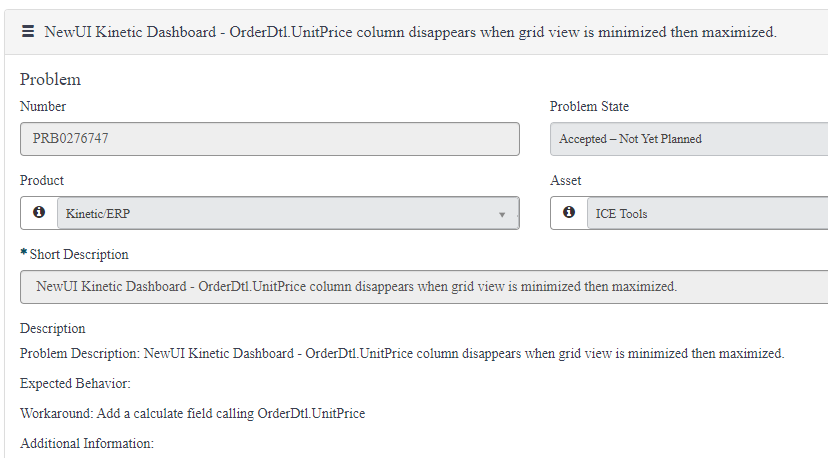

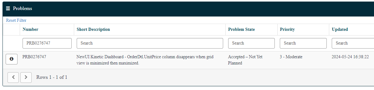

We now have an official problem for this - PRB0276747
Form - EpicCare (epicor.com)

Was this removed or something? I’m getting nothing from the link or from searching for that problem.
It’s still there, “Accepted - Not Yet Planned”
