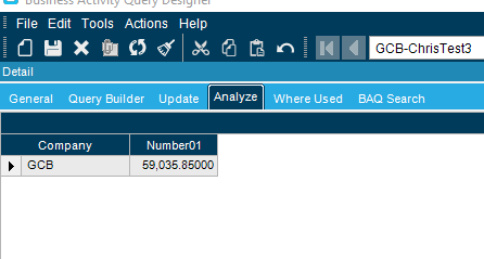

And yet it doesn’t show up as a field in the BAQ designer?
(Note that the UD fields appear at the very end of the field list).

It does in the BAQ designer. This is what is generating the error. It is from the Next Part button in Part Entry.

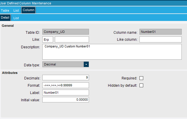

Number01 is an integer, no?

It is being stored as a decimal. See below. Also, I can edit and save the value in an updatable BAQ with no issues.
