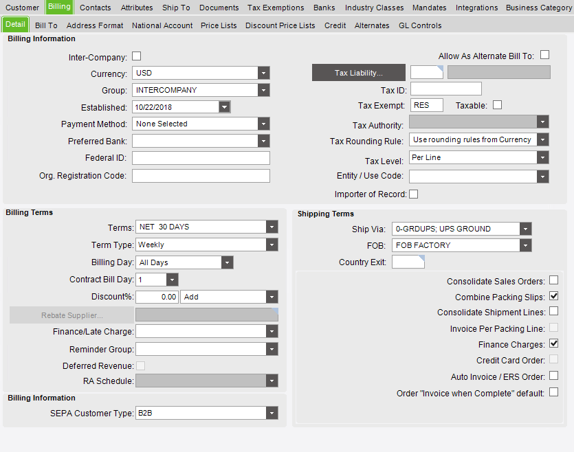

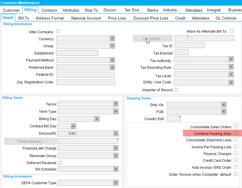

Customer maintenance has this field which should get you there.
Ross
Hi Ross,
I see that is checked. I saw somewhere in the past (version 8 post) that “advanced billing” module may be required for this to take effect. Is this the case?
Not that I am aware of. It really just consolidates multiple pack slips that are ready to invoice to a single invoice during the get shipments process. However, it is for a common order. If you want to do it across different orders I think you have to use consolidate sales orders as well.

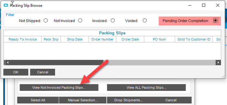

Ok. This one happens to be different packing slips due to being a back order on an “invoice when complete” order. I’m guessing I have to consolidate the packing slips. Where is the “consolidate” functionality?
In Customer Maintenance on the Billing/Detail tab. Sorry, I said consolidate but the screen says combine. Just check the top 2 checkboxes from the image above and see if that gets you there. If it is due to the invoice when complete it won’t grab it but you can see it if you check View Not Invoice Packing Slips and the radio button for Pending Order Complete.

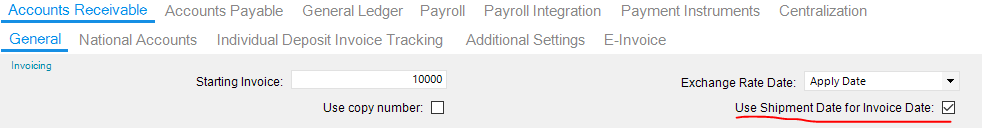

Does it help to remove the company configuration setting that states Ship Date = Invoice Date or is it all the same because the shipment happened in a prior period? I have never verified that.

Packslips are separated into periods when using option “Use Shipment Date for Invoice Date”, without it it should go to the same invoice provided other conditions are met.
AWESOME!
Seems to work perfectly.
Thank you Jonathan!
