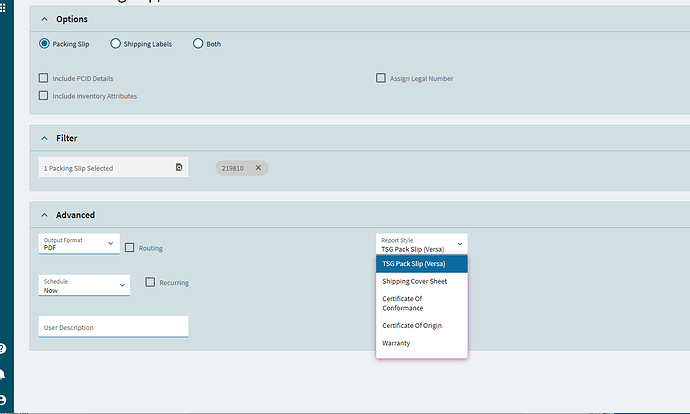

right now we print each report separately and in Kinetic depending upon the SO, the data directive generates the documents which can be multiple.

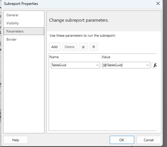

You need to pass the GUID down to the subreport. I would open one of the system reports with a subreport and see how they do it.
To John’s point: If you open the pack slip RDL, you can see that subreports have the parameter of TableGuid = [@TableGuid]. Other parameters are added depending on what is needed. For example, in the MarkFor subreport, there are also parameters for Company, PackNum, and PackLine. I would think you only need the tableguid for your purpose.
@NateS
I used the following parameters for the subreport. For testing purposes, both reports are identical and have the same Rdds, but the subreport is not showing up at all.
