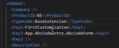

4. Change the customization into a base extension by changing the TypeCode AND he ProductID of the XXDef Object in the XML:
a.
5. Change the name in key1 to something based on best practices like "MyCustomization_BE," the "BE" meaning base extension.
6. Go back into Epicor in developer mode and import the customization file you just changed in steps 1-5.

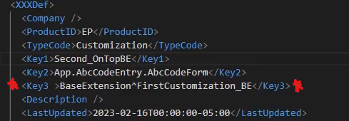

10. Insert a value in the Key 3 field of the XXXDef object with the value of your base extension prefaced by "BaseExtension^".
a. So the value would be "BaseExtension^FirstCustomization_BE"
b.
11. Now import the modified customization into your system.
