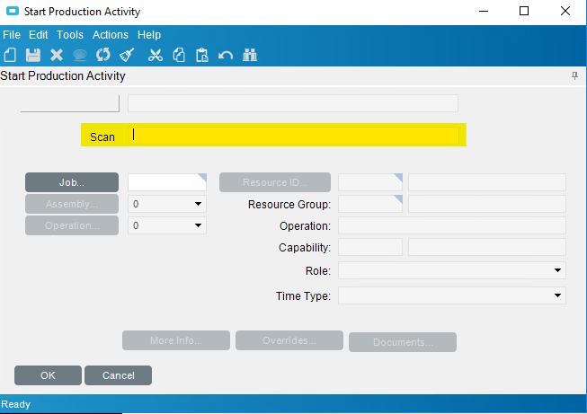

We have the same scanner. What I did was customized the start/rework/end activity screens and added a single text box. I came up with special delimiters that would tell the customization JobNum:Assy:Oper. I also had a “terminating” character that told the customization the scan was done. Then the customization loads the data through the adapter and fills in all of the fields.

When you use the barcode font, this will allow you to scan all three in the customized forms that will break down these fields into a customized scan text box:
Then Add in your view and add the code to detect the scan (example from Start Activity:

Thank you for this. So you created a new text field called Scan. This is where you capture the combined barcode. Behind the scenes is the code you provided to then take the full string and parse it out to the job, assembly, operation.
I’m an okay programmer, enough to be dangerous, so I need a bit of direction. The code you provided is add behind the text field somewhere.
I customized the Start Production/Rework/Setup activities in the MES screen. There I added a EpiTextBox that was called txtScan. Then the provided script should be able to be used in the Script Editor to capture the scanning events. You may only need to copy/paste certain parts.
