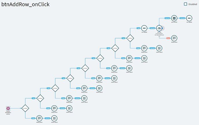

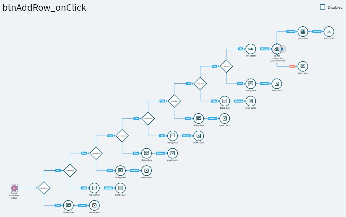

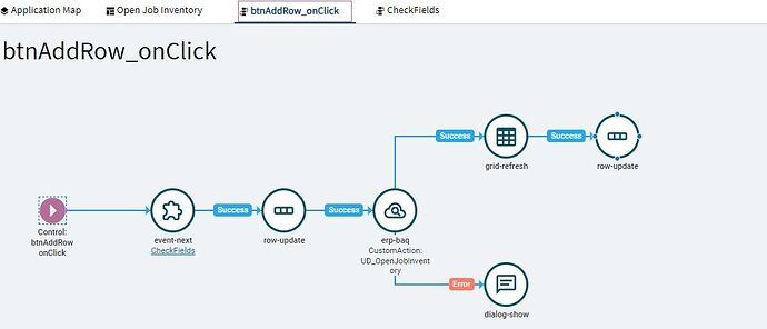

I can explain a bit more. The form I have is for temporarily storing inventory information before it is stocked properly back in Epicor. The first button I got working was AddRows. OnClick, the button fires off this event:
You can see the 8 fields where I perform the validation check. Basically, is this field blank? If it is then show a warning can cancel the event. If it is not blank, then continue the event. At the end it triggers my UBAQs custom action which adds the row to the UD table.
For my next button I want to implement UpdateRow. For this I will perform the same field validation to make sure the user didn’t delete a value from a field or leave it blank. I would like to copy the event conditions and dialogs into the new event so I don’t have to manually insert them. I can copy one widget at a time, but not a bunch of them all together.

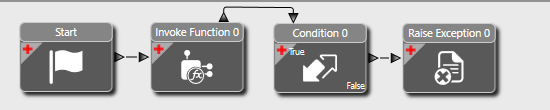

That’s literally what my screenshot above is from: a BPM attached to a ChangeJobNum method that sends the user an angry message when they attempt to create a job using a job# that’s outside of our tight requirements. Because people love using job#'s as arcane secret codes.

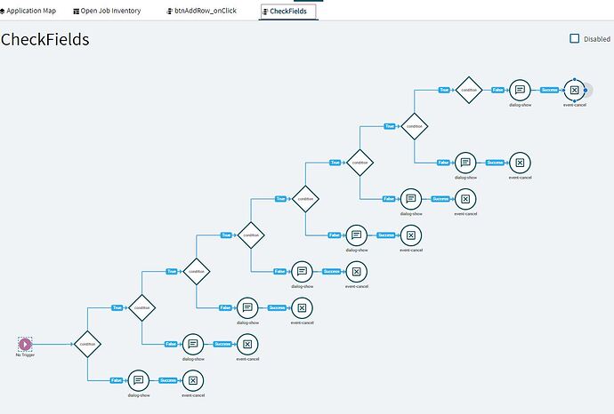

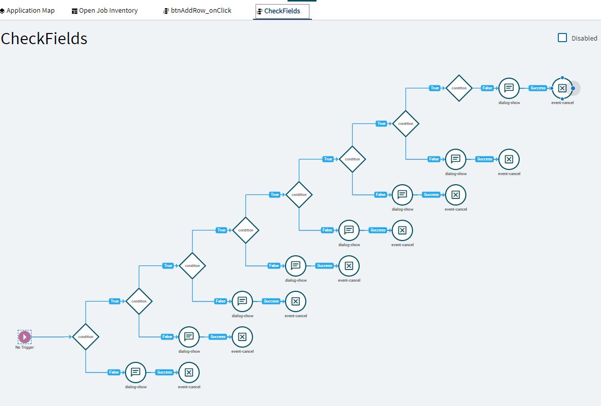

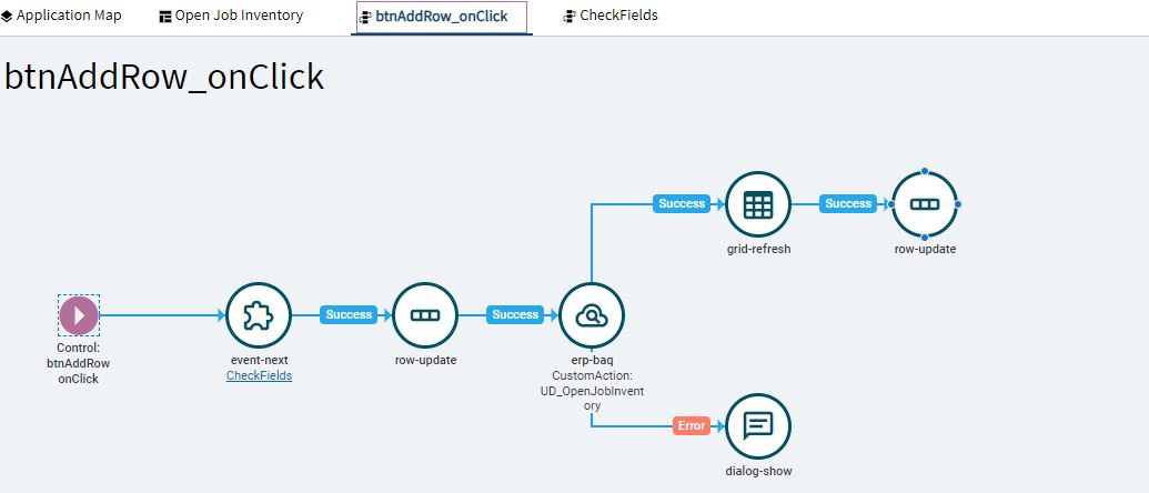

So I created a new “Event” called CheckFields. In there it just does the conditions and dialog boxes. Then in the button click event I use the event next to do the field check before committing the record. Did I set this up correctly? The data is getting into TransView OK, and getting into CallContextBPMData OK. No error code is getting returned from the try/catch. I am just getting the server side error again.
I ran into this when using event-next to avoid repeating code… I’m not sure what the best way to interrupt event execution is (maybe event-cancel is cancelling only the current event, not the whole string of events that follow it)
So I redesigned to perform my long set of conditions and set a variable to flag for cancellation that I checked after the even-next widget
It feels dumb to add another condition, but having your big condition set all together is important for if changes have to be made, you just change your conditions in one place (instead of hunting for all the events that have those same condition checks).
