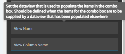

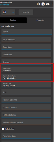

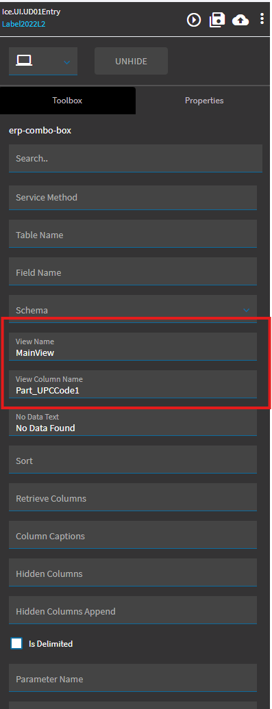

Under Reusable Combo, use the View Name and View Column fields

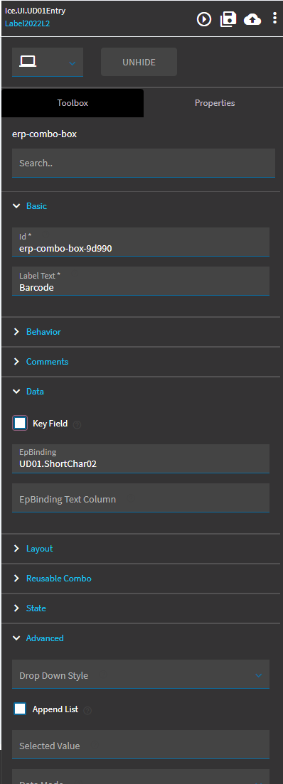

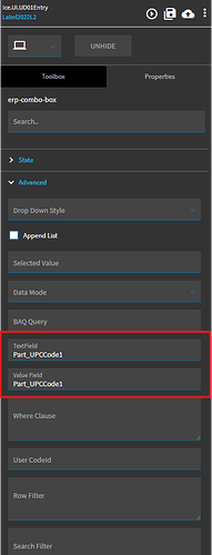

Don’t forget to fill in TextField (what displays) and Value Field (what gets stored to the UD Field) under Advanced

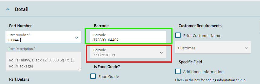

@jwphillips Thank you for the help, I am able to display it and it kinda “stores” the value. But what happens is that every time I go check another Part Number the field displays the previous value.
here’s an example. The first one shows the right value but it’s a textbox and the second one which is a combo box shows the value for the last record.

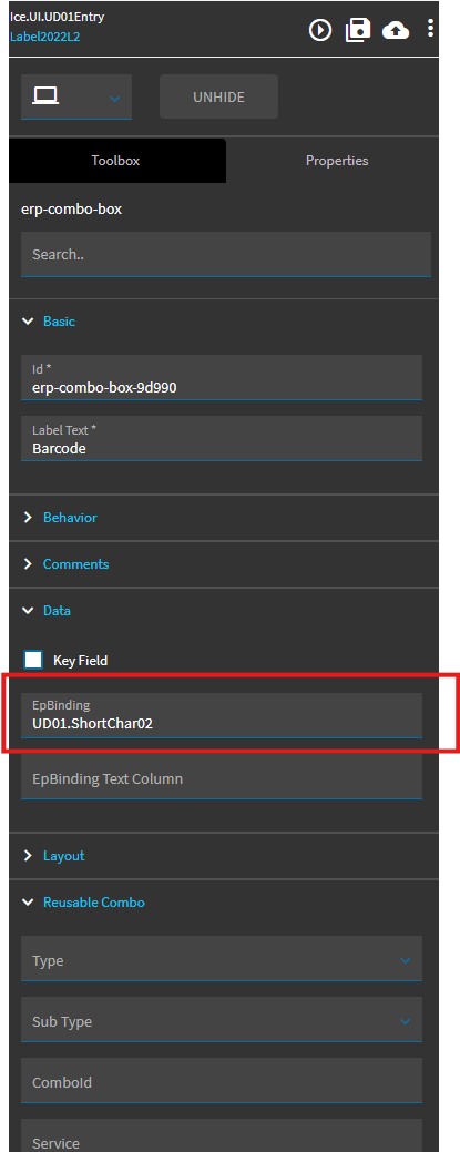

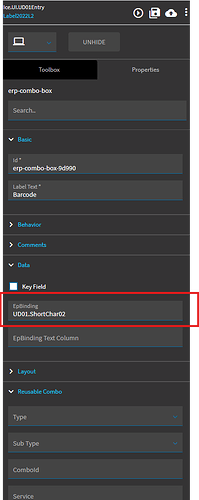

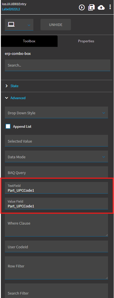

Here’s how I configured the combo box.
Should I have an event for that? I also thought of using the Row filter, which I also have no Idea how to deal with it.

That is maybe why it is not keeping in sync with the rest of your data - doing it that way will show whichever line of the dataview is selected, not the UD value for the current Part
How are you linking the barcode to the Part record? Is it stored in a UD field of the Part? Or it almost looks like you have it stored in a UD table and you’re matching it up in the client? - but then why would the barcode be in a combo? Where are you intending to save the selected value of the combo?
Usually, you define or retrieve a set of possible values (in this case, your dataview), then assign one of those values to a field (the epBinding - something like Part.Barcode_c or Part.ShortChar01 … some field that will hold the selected value)
