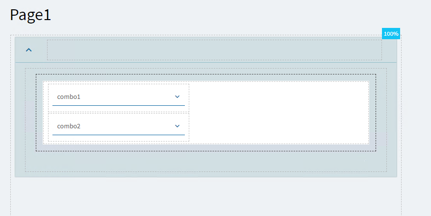

For an example, a simple configurator that only has two combo boxes, combo1 and combo2.

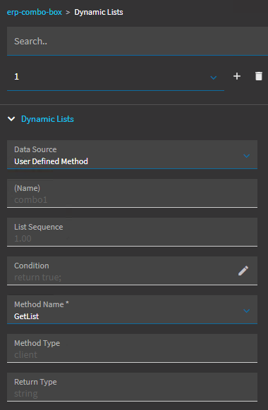

Both combo boxes are set for a dynamic list, populated by a UD method (GetList). The UD method code is dynamic depending on the current option selected in combo1. The logic being that if combo2 has Item B selected, no combo is able to select Item A.

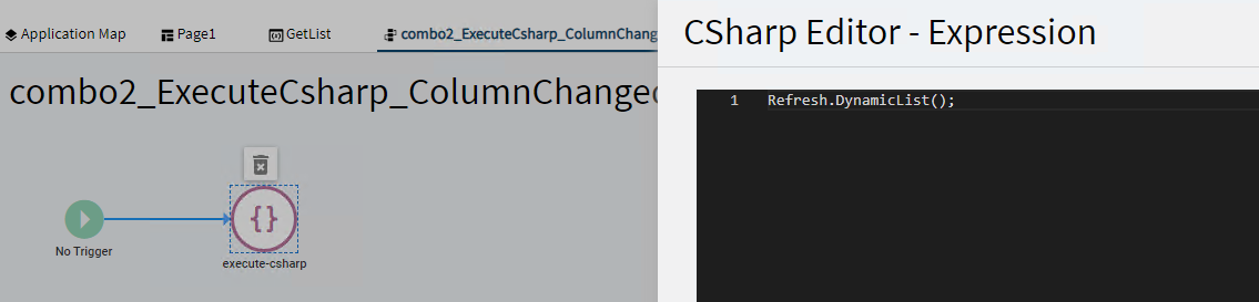

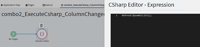

Since the contents of each combo box depend on what is selected in combo2, the dynamic list needs to be refreshed every time the selection of combo2 changes. A refresh to dynamic lists is added to the ColumnChanged event of combo2.

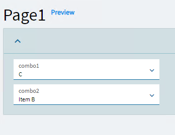

The filtering works as expected, but if an option is selected in combo1, and the refresh event is triggered on combo2, the description for combo1 becomes the value for some reason in the UI. It is important to note that this is only on the UI. The property of combo1.Description is still “Item C”.

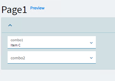

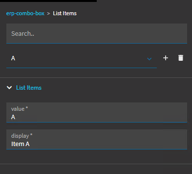

Before selecting anything in combo2:
After selecting anything in combo2:

I would recommend being very judicious with the use of “Refresh.DynamicList()”, this will cause all combos to refresh and to your point cause additional delays. As your configurator grows, this is harder to maintain and introduces a lot of unnecessary refreshes. You can specify the combos you want to refresh specifically by listing them Refresh.DynamicList(“combo1”, “combo2”);
Sometimes I find it more efficient to let the combo determine when it needs to refresh, place the refresh dependencies on the target combo instead of the other inputs. This way all the “logic” is in one place.
To do this simply reference each dependency in the Dynamic List condition. Similar to what you did with the UDMethod.
