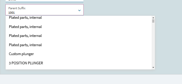

Combo box in kinetic to display text along with the value

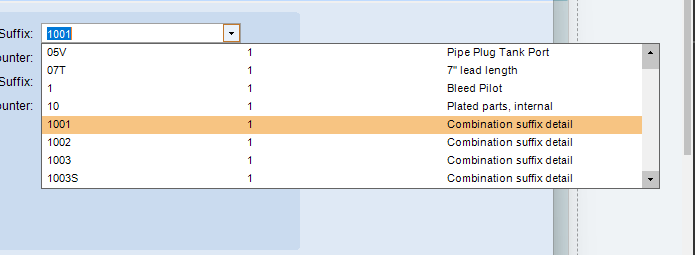

Can combo box in kinetic display values like in the classic screen?

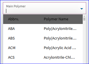

Yes, in the combo settings, just pull in multiple columns in Retrieve Columns:
Results:

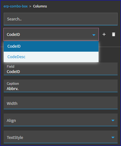

I should expand on that a bit… you can retrieve all the columns you want. But then you can arrange and add headings, etc. under advanced > columns
This is also where you can change the width of the information displayed in the dropdown, etc.
