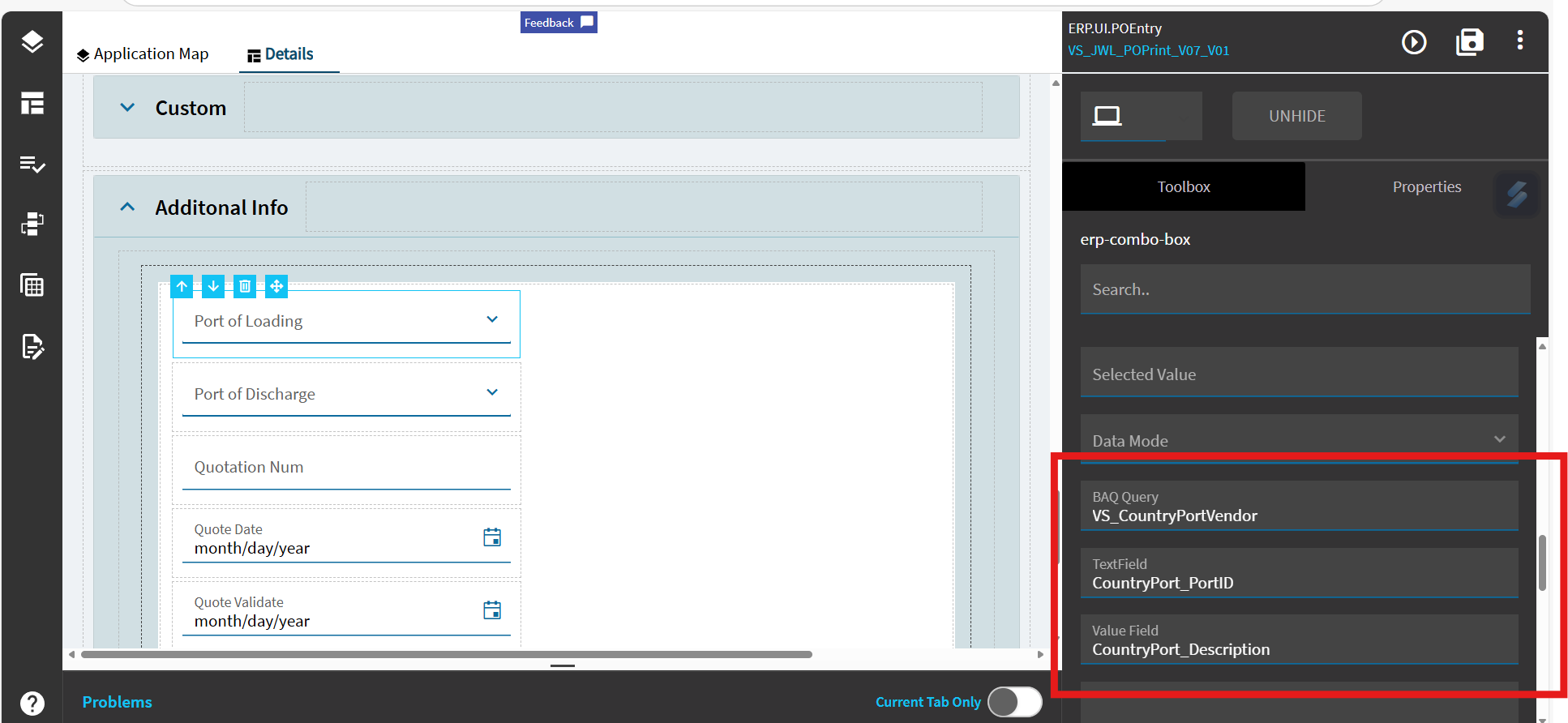

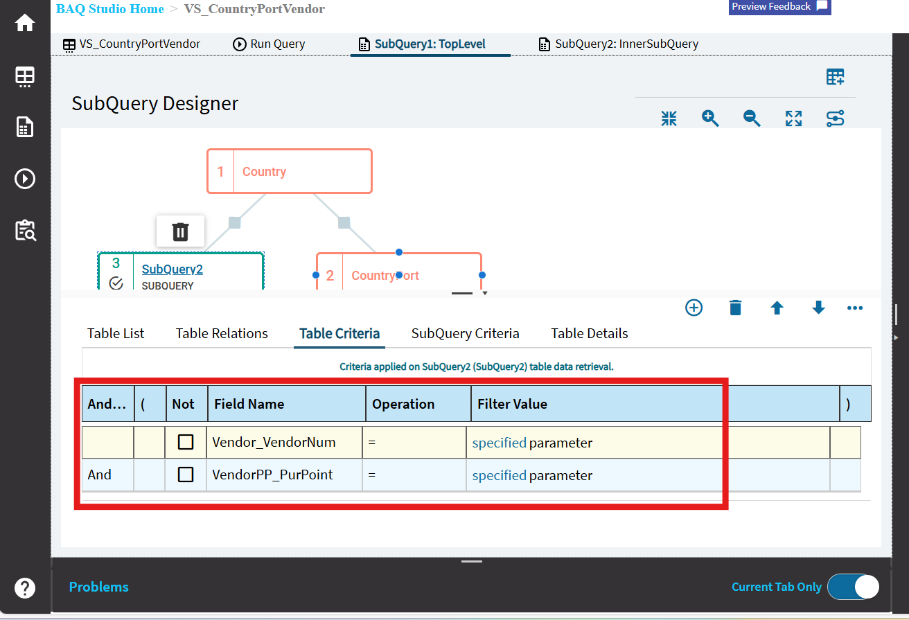

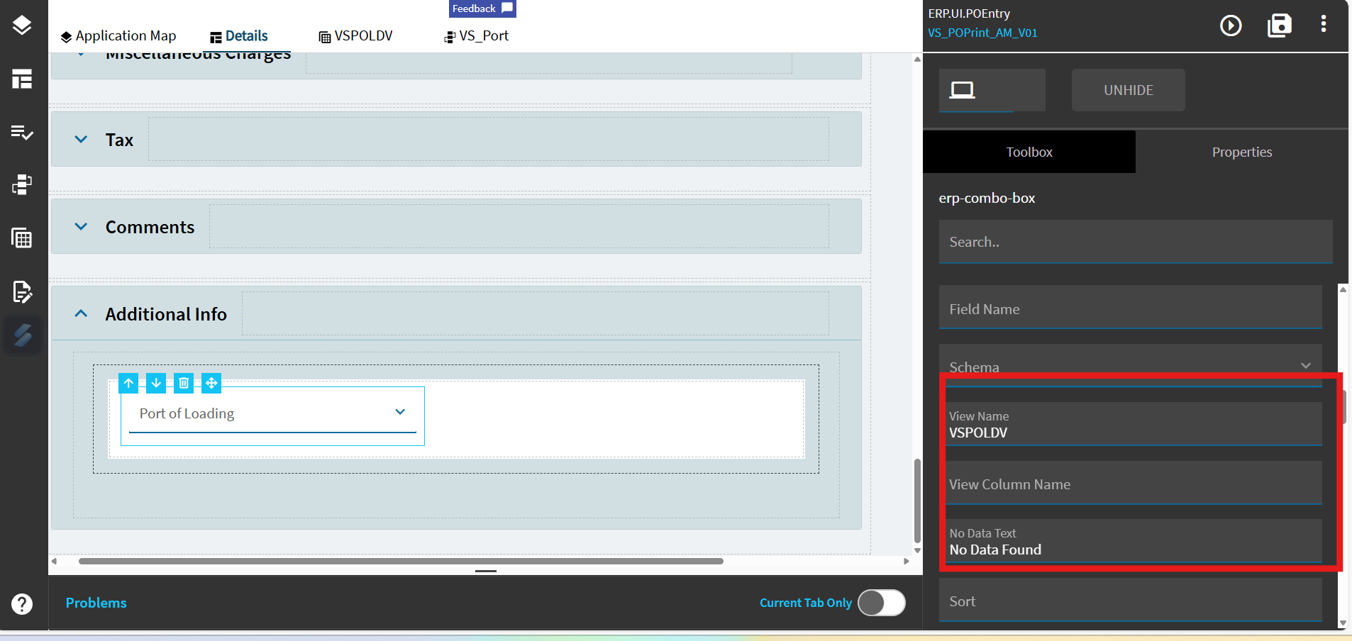

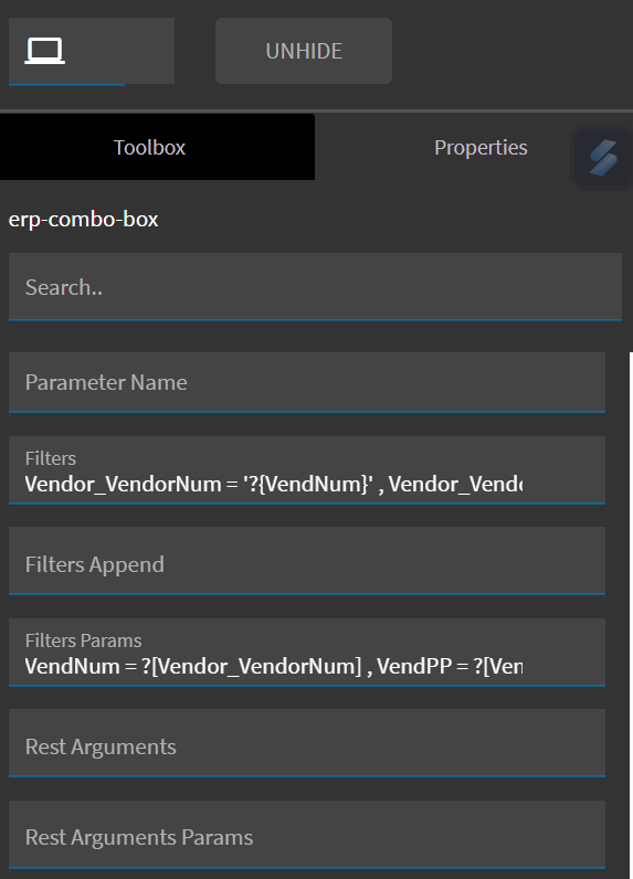

I recently encountered a scenario where I need to bind a BAQ to a combo box that has parameters.
I have set up the combo box binding as shown in the image below. In the Filter Parameters section, I have defined my parameter. However, when I try to run the combo box, it shows that no parameter is being passed.
Am I missing something in the configuration?
Filters : Vendor_VendorNum = ‘?{VendNum}’ , Vendor_VendorPP = ‘?{VendPP}’
Filter Param: VendNum = ?[Vendor_VendorNum] , VendPP = ?[Vendor_VendorPP]
Thank you in advance!

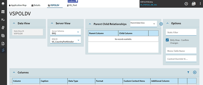

I think you would have to trigger a kinetic-baq event to populate a data view because that is where you can bind a parameter. And then bind your combo to the dataview. Or maybe not but that is my first thought.
Hello @aosemwengie1,

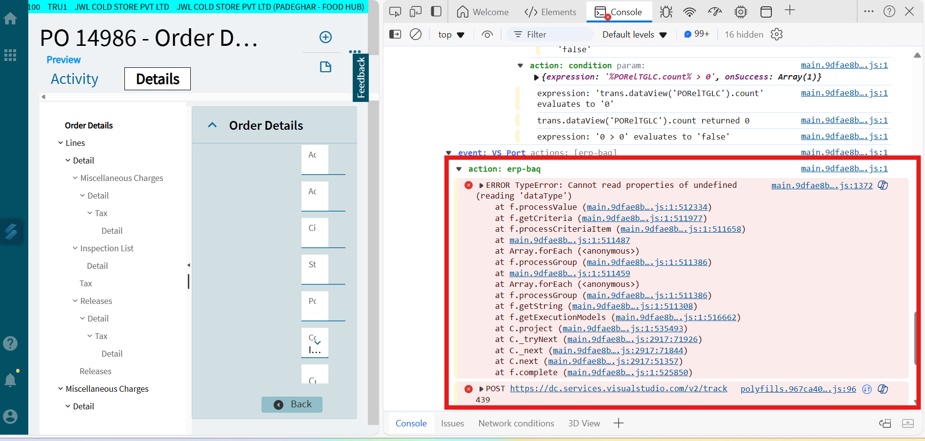

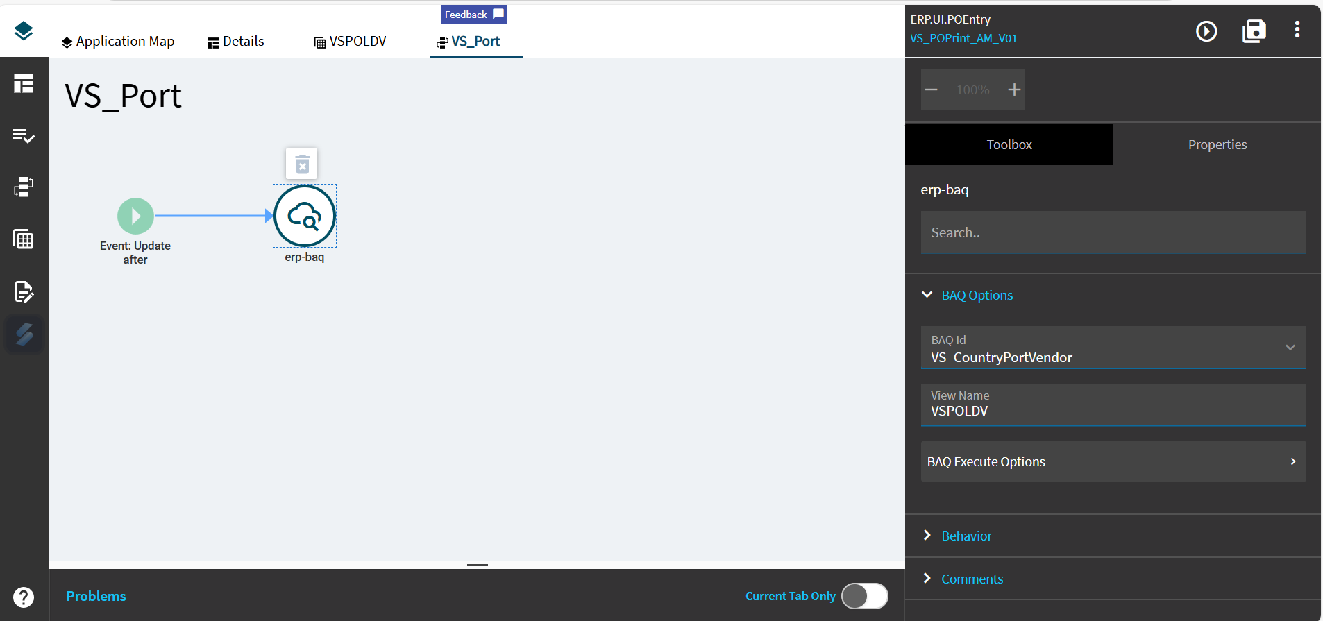

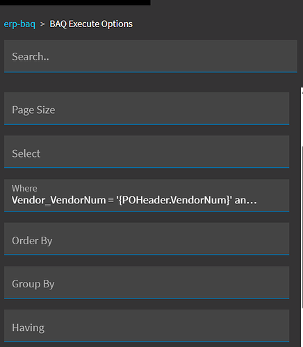

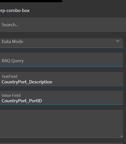

Thank you for your response. As you suggested, I tried using the Kinetic-BAQ widget and set my BAQ parameters within it. I also bound my ComboBox to the DataView, which is in turn bound to my BAQ. However, when I execute this and check the debug log, the following error is displayed. Am I missing something? Kindly let me know.
Where Condition :- Vendor_VendorNum = ‘{POHeader.VendorNum}’ and VendorPP_PurPoint = ‘{POHeader.PurPoint}’
DataView attach to BAQ:-
ComboBox Configuration:-

Did you use the guided setup to create the dataview? It will set everything up for you.
