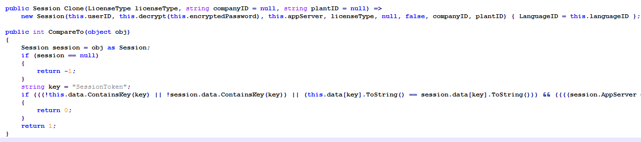

I did get this.oTrans.Session.SetUser(“manager”, “manager”); to work, it works perfect - but acquiring the session takes 30 seconds and not sure what else I break in the process of switching users like this. Plus I have to revert back; unless I make a clone of the Session or my own Session Object with ILaunch
Perhaps I should be using Session.SetCredentials instead ?

I’ll tinker around :slight_smile: As long as I clone the oTrans.Session i should be okay, don’t feel comfy messing with the original session User in Transaction.
