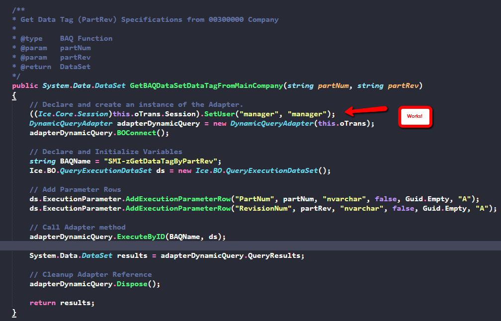

@Bart_Elia Quick Question:
Let’s say I have a Cross-Company BAQ and the User does not have access to ABC Company. Is there a safe way to Impersonate the Adapter to execute as a different user.
This here works, a little slow - just poking around; but not sure what the consequences are and if there is a safer / recommended way to just execute this BAQ as a diff user (Service Account).
There is also a Session Clone Method so I could Clone this.oTrans.Session and pass in a cloned/modified one to the Adapter so the original this.oTrans is untouched, and use MyClonedSession.SetUser(“ServiceAccount”, “pw”);
The Dynamic BO also has some code that does:
queryRequest.Session["ImpersonatedUserName"] = this.Session.UserID; // Perhaps one can use this?
What about doing an “Updatable” BAQ and in the GetList() post-processing go fetch the stuff you need using the DB. object. This doesn’t require a new session.
Pain is that its a complex BAQ that has PIVOT, Joins, Sub-Queries etc… and it Crosses Companies for certain Data - its a mixture, but if the User doesn’t have access to ABC Company, the result is Empty.
Only other thing I can think of is use the DynamicQuery BO Instead and create a New Session in a using block.
