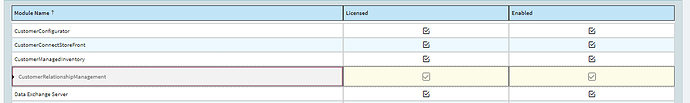

I would double check that the CRM license is enabled. You can see the list of modules and their status in Company Configuration.
Hello John,
thank You for your reply. - Yes I also thought this will be the issue - but I believe license should be ok - also configuration for Quote is greyed out for me - it feels strange.
If the CRM module is licensed (and it is), there are several settings that have to be set in Company Configuration BEFORE you can add customers in the LIVE, TEST, or PILOT environments. The DEMO environment has these settings already, and the System Flow course is designed to work in that environment.

thank you for your time and help - yes I understand that several things need to be set up upfront - but even if I create all these bits in respective Main Menu > CRM > Setup menus - in Company Configuration I am still NOT able to select them as all fields are greyed out - as I am showing on my first picture - that is where I am struggling.

Yes I have all the GL’s in place, I have checked the license (new license with CRM has been added and enabled).
