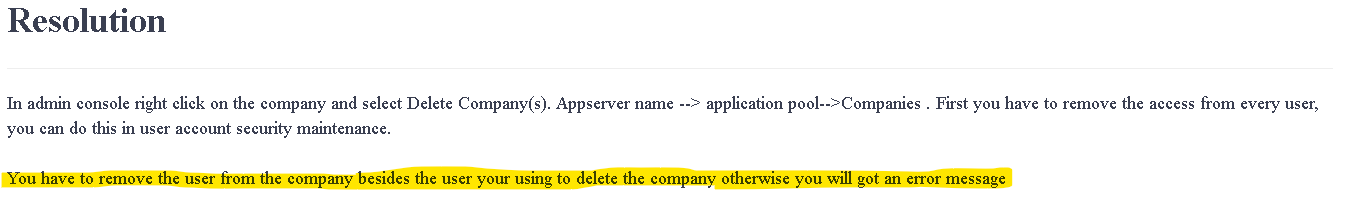

There is a KB in Epiccare about Deleting a Company.
If you followed those steps and still not working, I guess you could ask Epicor support to provide a datafix to physically remove it from DB.
