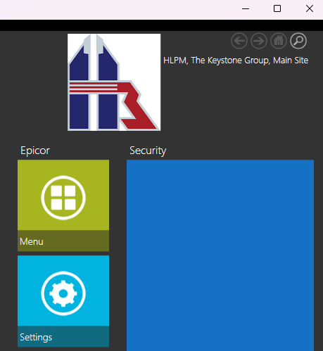

How does one change the logo in the top right of the Epicor screen?
I’ve updated the “Logo Image” in Company Maintenance, cleared my cache, logged out of Epicor and back into it, recycled the application pool, etc. I even reinstalled the client on my Workstation, to no avail.
Since that didn’t work, I am assuming that it may have to do with the theme that is applied, but other than changing the colors, I have never played around with the themes too much.
EDIT: I also tried changing it under Settings > Appearance > Set Logo Image (and applied it to the current company)

I deleted everything related to Epicor under %AppData%\Local and %AppData%\Roaming, as well as C:\ProgramData\Epicor, C:\Epicor\ERP10.2Client. Then I recycled the application pool and reinstalled the Client (since I deleted C:\Epicor\ERP10.2Client), and it is still the old logo.
I am stumped.

I just opened up that new environment on a workstation where it has never been opened before, logged in as a brand new user that I just created, and it still shows the old logo.
