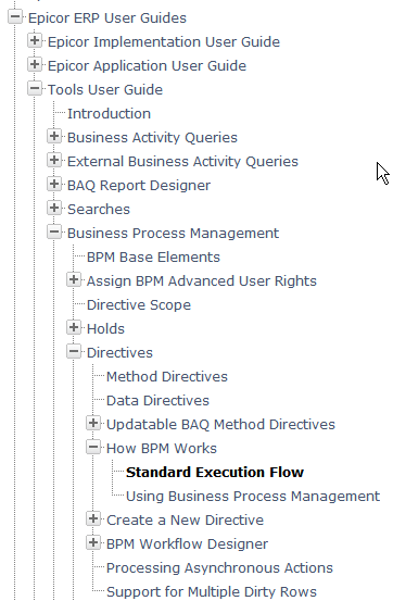

Also, your help files, or Epic Web has the tools guide which will introduce you to some BPM’s. I would spend some time with that.

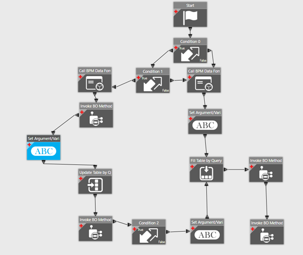

Thanks Brandon. The first image is just of my whole workflow. The next three are of the area I am having the problem.

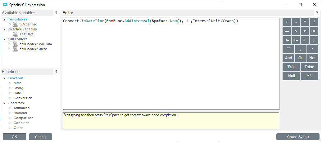

I was very confused how to implement the above article within expression editor. However it did help me further google my issue. Which lead me to the always helpful stack overflow. Ended up being able to just use Convert.ToDateTime() to solve this problem.
A lot of times you can just straight cast it too
((DateTime)BpmFunc.AddInterval(BpmFunc.Now,-1,IntervalUnitYears))
As an aside we try to avoid BpmFuncs and use their real C# counterparts when doing a custom expression. I can’t remember exact cases of when or why but we have had those mess us up a few times and the ‘real’ C# versions worked better without the EpiMagic.
