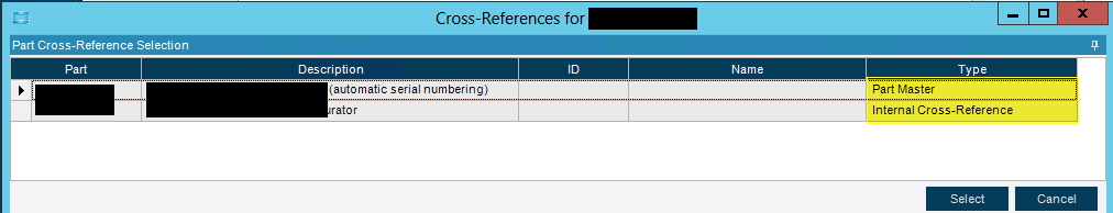

This is good to know about (Thank you @Beth! :slight_smile: ) and I could see it being useful. I was curious what would happen if you, by chance, entered an Internal Part Cross-Reference Record that just so happens to match a Part that you already have in your Part Master. It looks like you are presented with a Cross-References window where you can then select the Part that you want to use:
I wouldn’t want that window popping up all the time and would probably modify the Internal Cross-Reference Record(s) with maybe an ICR_ before the Reference Name or something like that but…
Cool Beans! :sunglasses: :+1:
