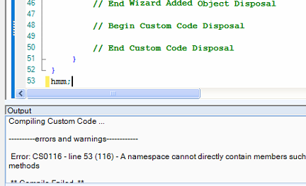

I’m working with Kenteic and wondering if anyone has see the Customization compiler displays the wrong line number. To give you an example, I opened the base code of any form and type a bad code then compile (F5). The error should indicate line 53 instead of 112.
If you click All Code you will see all the hiden code that is there which gets you to the right number.

That didn’t give the correct line either. On other codes I have written, clicking All Code changes the error line number but still does not match. In the simple example above, checking the box does nothing and does not change the lines since it’s a brand new customization code.

When I export the customization and open it with Notepad I can dee that the code is double spaced. Could this be the issue? I’m wondering if this is a Kinetic issue or some OS, VS or server setting. I haven’t seen this with E10.

Thanks Kevin for the info. I upgraded to 2021.2.5 and confirmed this issue had been resolved. This is from the release notes:
2021.2 Tools and Technologies ICE-CustomizationEngine |
CUST
Resolved Issue ERPS-162253 Customization script compiler points to the incorrect line
number, making it very complicated to troubleshoot the code
PRB0234843
