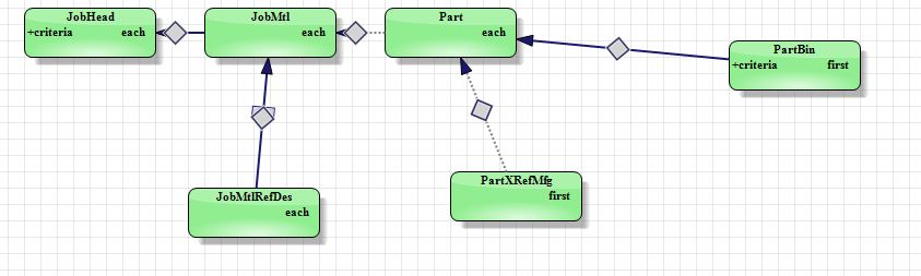

I’m assuming your using the PartMtlRefDes table?

I’m actually using JobMtlRefDes but I think it doesn’t matter.
Capture2

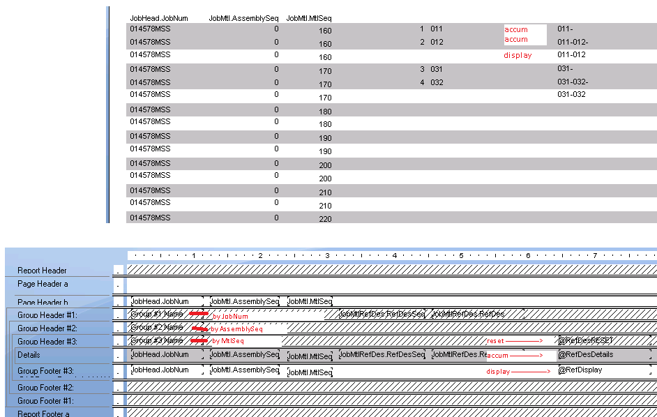

Do you have any grouping in Crystal (or a subreport)?
e.g.
Group by JobNum
Group by AsmSeq
Group by MtlSeq
  • detail lines hidden — formula RefDes detail - add to string
    etc…
    Display/print at a Group footer level - to display the final string… and any other fields you need
If you just put the formula in detail lines… probably why you’re still seeing one label for each RefDes
Ref screen shot below - lines in grey would normally be hidden =- I display only so you could see what is going on.
Note formula examples from TekTips with some minor adjustments
//{@accum} to be placed in the detail section:
whileprintingrecords;
stringvar x := x + trim(totext({BAQReportResult.JobMtlRefDes.RefDes}) + “-”);
//{@display} to be placed in the group footer:
stringvar x;
if x > “” then
left(x,len(x)-1);
//{@reset} to be placed in the group header:
stringvar x;
if not inrepeatedgroupheader then
x := “”;
