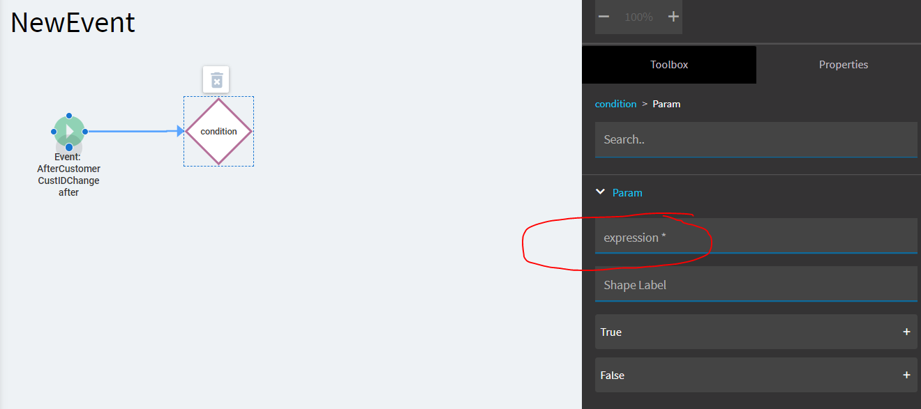

I am trying achieve a similar behavior with an Event in Application Studio, but I am unsure of the syntax.
How do I write the expression in the condition in Application Studio that will run for:
The user who called the method (belongs or does not belong) to *** group (and I would want to list multiple groups; or I would chain condition statements).
I assume I would put the expression here, but I am unsure of the syntax:
Can anyone provide a little guidance? (I did not see any help in the “Working With” AKA “Hands On” courses for Kinetic) .
