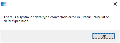

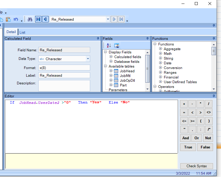

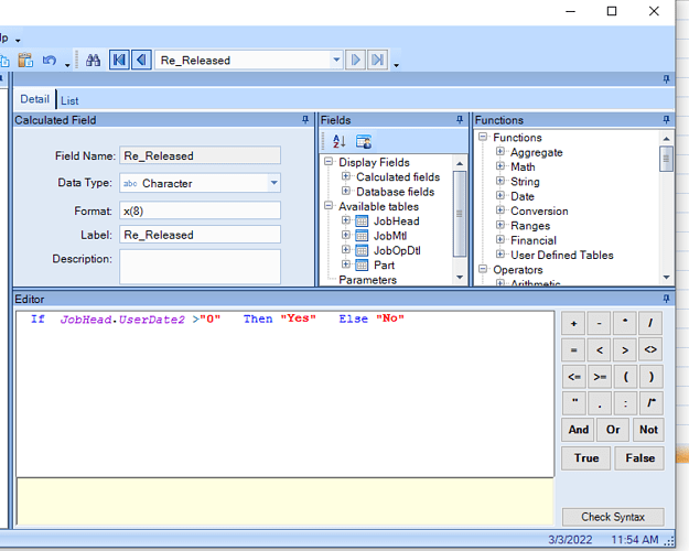

Here is the code I put into the calculation
and it said the logic was fine. Until I executed the report and I received this error.
I would appreciate any assistance on this.

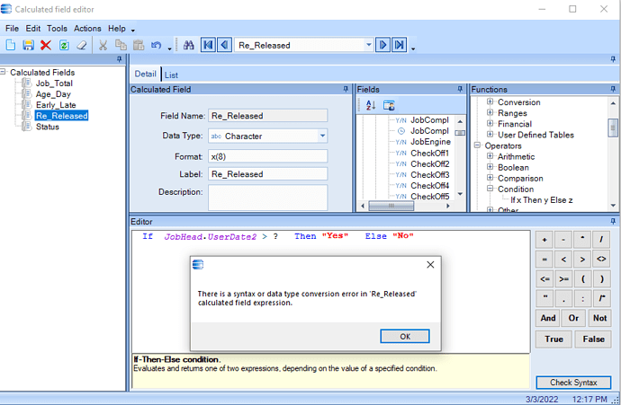

Hello Marc,
Now I get the following message.

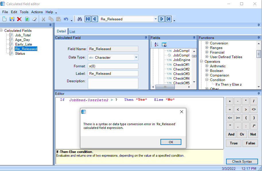

If JobHead.UserDate2 = ββ Then βYβ Else βNβ
Now getting this error from the setup (See below)
If JobHead.UserDate = ? Then βYβ Else βNβ
