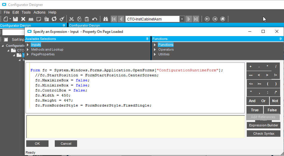

You can do this
 Form fc =  System.Windows.Forms.Application.OpenForms["ConfigurationRuntimeForm"];
  fc.StartPosition = FormStartPosition.CenterScreen;
  fc.MaximizeBox = false;
  fc.MinimizeBox = false;
  fc.FormBorderStyle = FormBorderStyle.FixedDialog;
Another one that can be used if you want to remove the ability to click X to close the window.
fc.ControlBox = false;

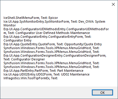

The “ConfigurationRuntimeForm” object exists only after the form completely loads. If I place this code in the On Loaded event, I get an “object not set to an instance of an object”. However, as a test, if I place the code in a button, it finds it.
string forms = “”;
foreach (var f in System.Windows.Forms.Application.OpenForms)
forms += f.ToString() + “\n”;
MessageBox.Show(forms);
Inside On Loaded event:
Inside Button click event:
You can see the ConfigurationRuntimeForm at the bottom which doesn’t exist in the On Loaded list.

I used this in On Page Loaded (can sometimes be redundant)

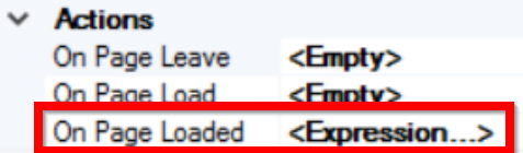

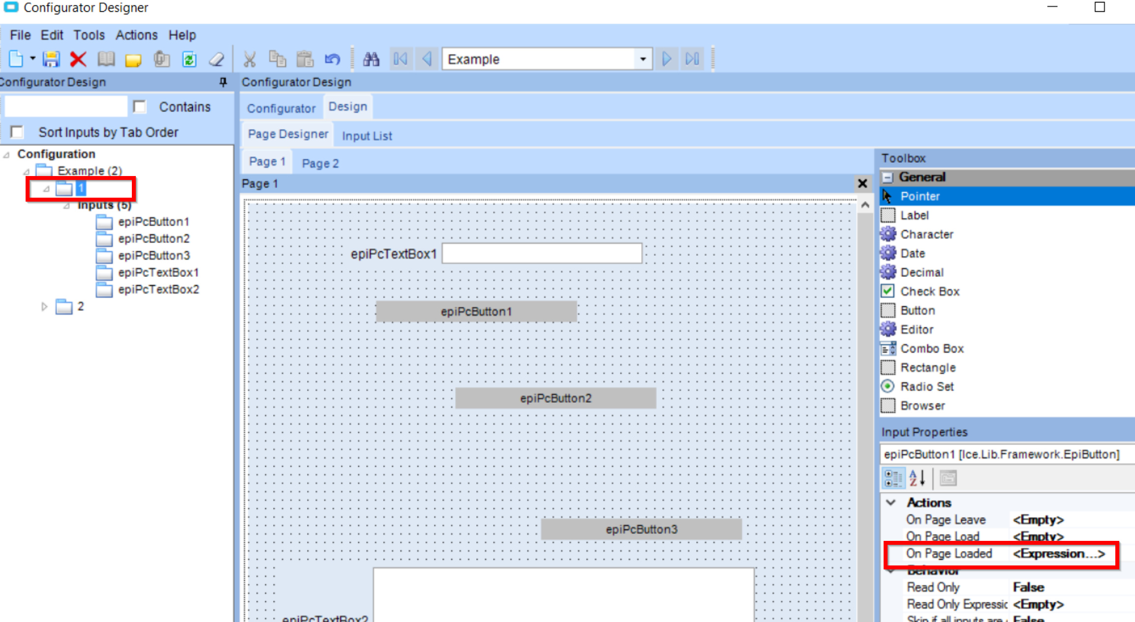

This code will not work in the On Loaded event of the configurator and should be just in the Page On Loaded. Having it only in the Page On Loaded will do what you want. If you remove all code from your On Loaded of the configurator does this then pass the syntax check?
Is the Page On Loaded event here?
If this is the Page On Loaded area, I have the code inside, but still get the same error.
That is the Configurator On Loaded Event. See this for On Page Loaded event
That was were I first placed the block of code and received the Null Exception reference error. Same as the Configurator On Loaded.
So this is interesting. In Page 2 On Page Loaded this works which is where I have used it. For Page 1 it does not work. I am checking to see if something else is going on.
If you dump this code in Page1 On Loaded event and Page2 On Loaded event, you can see that “ConfigurationRuntimeForm” object doesn’t exist (at the bottom of the messagebox) on Page 1, but does on Page 2.
string forms = “”;
