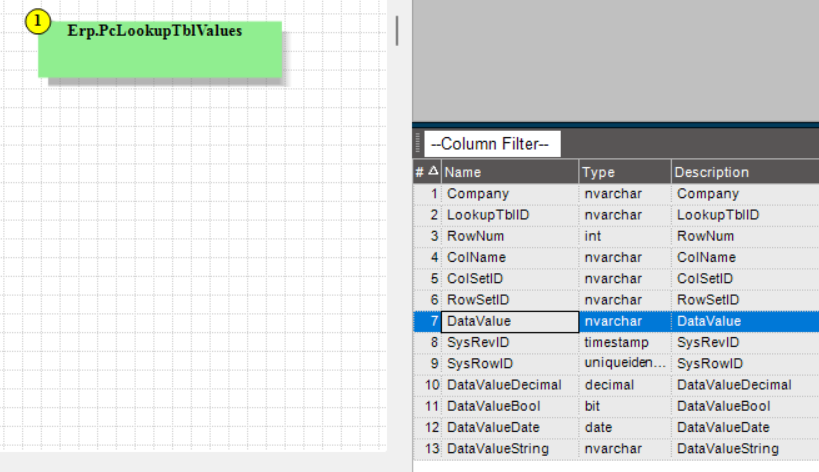

The VALUES in all configurator lookup tables are here:
Wow, this is a long time ago! So, what I did (back then) was to create a hidden input for each table I was downloading. I wrote a server side UD method that would read the PCLookUpTbleHed (and column sets maybe :thinking: ) and created a delimited string for the column headings. I think I also had a row delimiter to search the rows. Again, this was a while ago. I then created a delimited string with the data from PCLookupTblValues for that ā€œtable.ā€
The trick was Epicor does not enter a record for an empty cell, so I had to ensure there was a placeholder (extra delimiter) for the missing column.
This happened when the configurator opened. I then used a client UD method to pass in the table (the hidden input), the key for the row, and which column I wanted. I used the regular Epicor functions that processes delimited strings (index, etc.) to find the column number then then grab the associated column for the selected row. It was wicked fast compared to calling the PCLookup methods, especially from Germany when SaaS was in Iowa.
