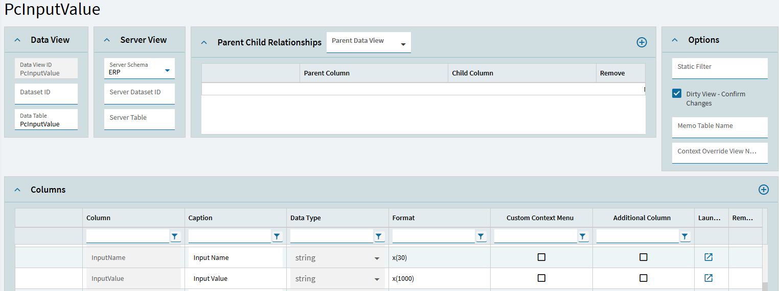

I made a BAQ to take information from PCInputValue to get configurator data from a quote. I am having an issue where the value PCInputValue_InputValue is not showing the entirety of a string, it only shows about 50 characters. The display fields shows that the format is in x(1000), so that should be plenty of space.

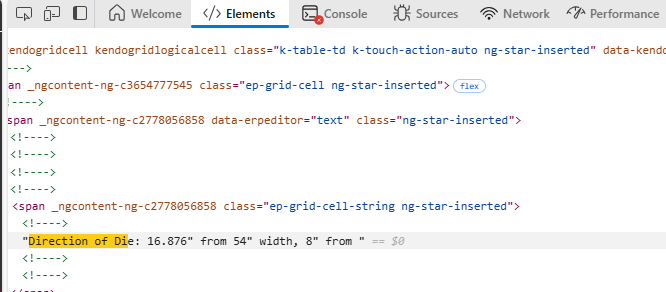

This is supposed to show “Direction of Die: 16.876” from 54" width, 8" from 600" length" but it is only showing everything up to the word “from”. This happens with all longer strings that are displayed in the BAQ.

Is this what you mean? It looks like only the first 50 characters are being pulled based on the development tools.

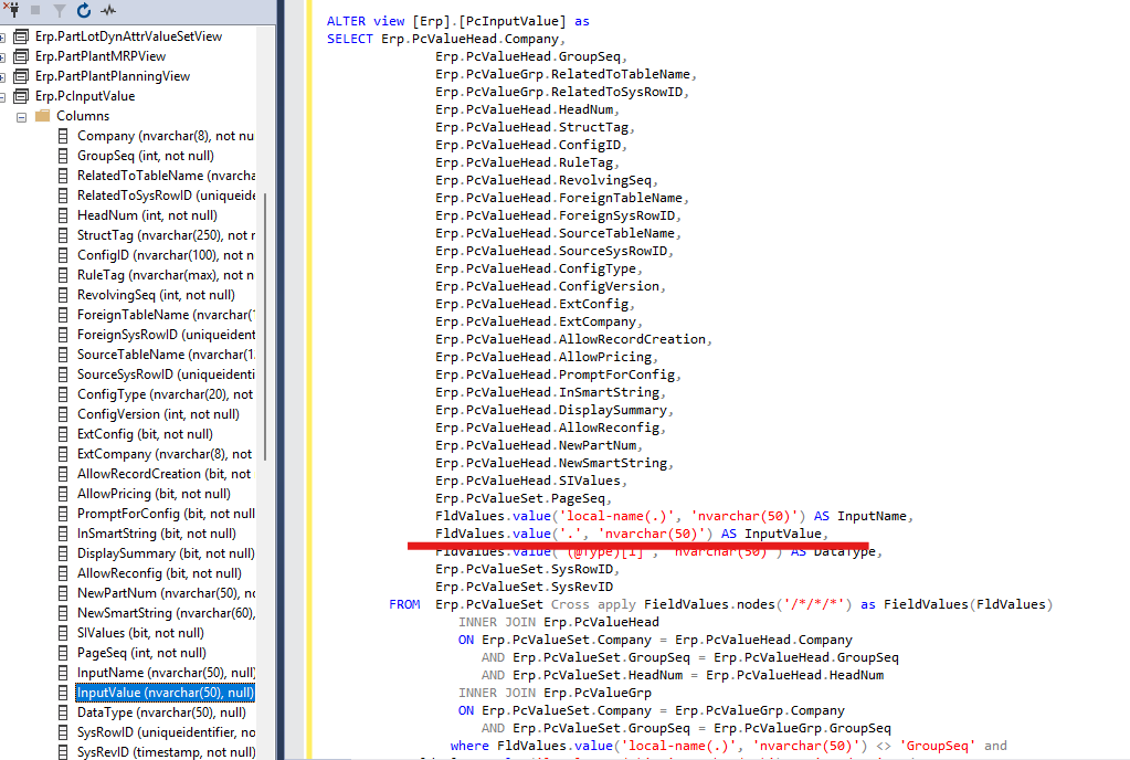

PCInputValue is a view that only shows nvarchar(50) in InputValue field
That is strange. The BAQ shows that PCInputValue has a format of x(1000).

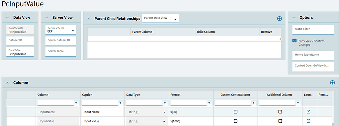

In configurator designer, I looked at the PCInputValue view and saw that it also had a format of x(1000)

BAQ format is just a string, it does not change underlined data.
You cannot change system view yourself, you have to report it if you think it should be different.
Right now you can probably create BAQ based on underline table with XML data and try to retrieve node from it using calc field for example.
It is Erp.PCValueSet table, column FieldValues.
