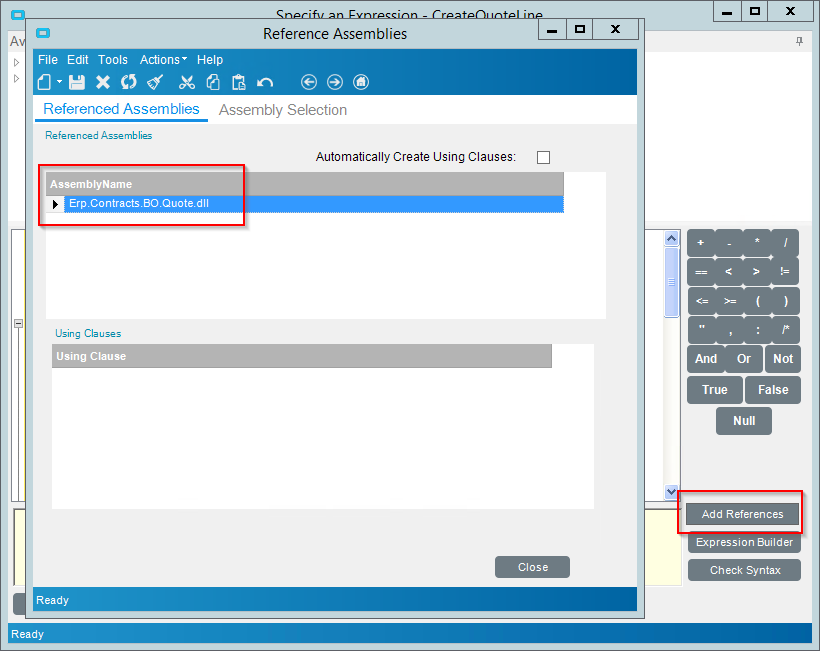

Here’s something I’ve done to create quote lines from a configurator using a BO method.
There’s a UD method named “CreateLines” that calls “CreateQuoteLine” to create a new line.
In CreateQuoteLine I added the reference for Erp.Contracts.BO.Quote.dll:
Here’s the text of UD method CreateQuoteLine:

Caveat: This was running in 10.1.500 Test environment, I think. In order to use the import feature to load this into another environment I had to go into the XML and delete the assembly reference. It likely had to do with where the assemblies were stored on the new environment.
Something like this:
Delete this from the exported XML

After the import I just added the references again.
See if that helps.
Your mileage may vary.
