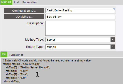

We made some super simple test methods as follows:
Client method:
// Client Method for returning a string array
string[] strTmp = new string[4];
    strTmp[0] = "Testing Client Method";
    strTmp[1] = "One";
    strTmp[2] = "Two";
    strTmp[3] = "Three";
return strTmp;
Server method:
// Server Method for returning a string array
    strTmp[0] = "Testing Server Method";
    strTmp[1] = "Four";
    strTmp[2] = "Five";
    strTmp[3] = "Six";
return strTmp;

using a classic configurator, I will test this in Kinetic next
Client side, it is called as an on leave event for one of the radio buttons.

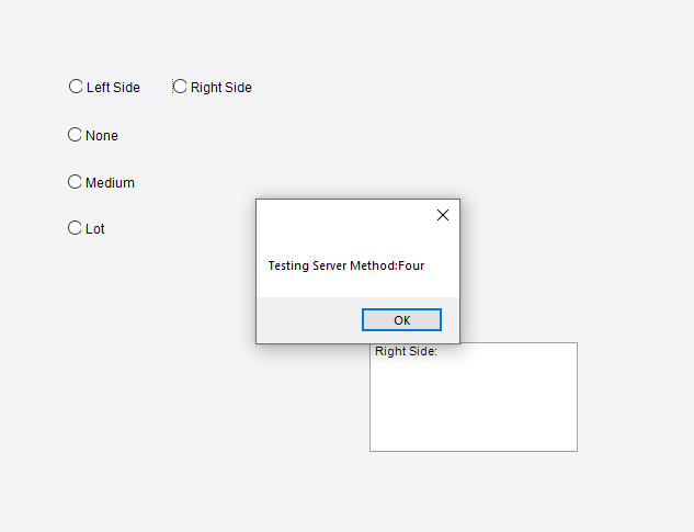

Result
We have a bug with Kinetic. Code works fine in Classic, but not in Kinetic. Kinetic doesn’t handle a server side method that returns a string array. Gives no error or indication that things aren’t working.
