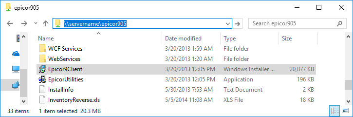

We use Citrix and offer up several different versions of Epicor to our Citrix Users. If you want to run both versions on a PC you install the Epicor9Client from .701 on the PC (I believe the ProgramData folder just contains temp files for each version…if the .701 client is already installed on the PC, you’ll probably find the Client files somewhere like C:\Program Files\Epicor Software\ (the default) - this will contain a copy of the \servername\Epicor905\Client files from your .701 LIVE server)
then install the Epicor9Client from the .702 server on the same PC, although you’ll want to be sure to rename the folder to something like C:\Program Files\Epicor Software\Epicor702Test. And if you choose which shortcuts to create during each install you will hopefully see one set point to your .701 and another point to your .702 Mfgsys.exe program in your Client files. (Of course it would be good to rename these… :wink: :+1: )

Very nice reply, pictures and everything !
I think this sums it up nicely, I will just have to make sure that my Target line contains the right pointer to my E905702.mfgsys file and the contents jibe.
