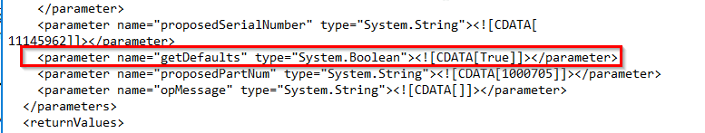

We are doing this in the HelpDeskSvc, the method in the trace log is OnChangeSerialNumber. What we are trying to figure out is having the API provide the ‘Yes’, but we may have to pull the data in a different way.
I have forwarded your questions and insights to the developers, thank you
Do a trace with both and see what the difference is. From a quick test, looks like it’s the parameter getDefaults - False for no and True for yes:

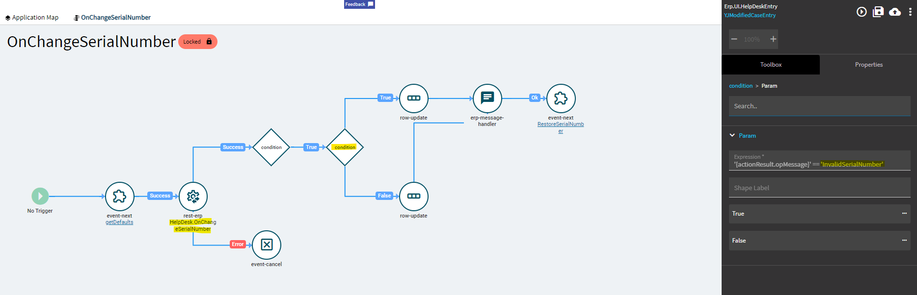

Hi, I’m on the same screen (I’m new to Kinetic UX).
I’m also trying to figure out how to customize the validation logic for this error message. Our Tech Service team wants to input legacy Serial Numbers without encountering the error ‘Invalid Serial Number.’
This error message comes from REST-ERP: Erp.BO.HelpDeskSvc.OnChangeSerialNumber.
Any advice on this would be greatly appreciated!

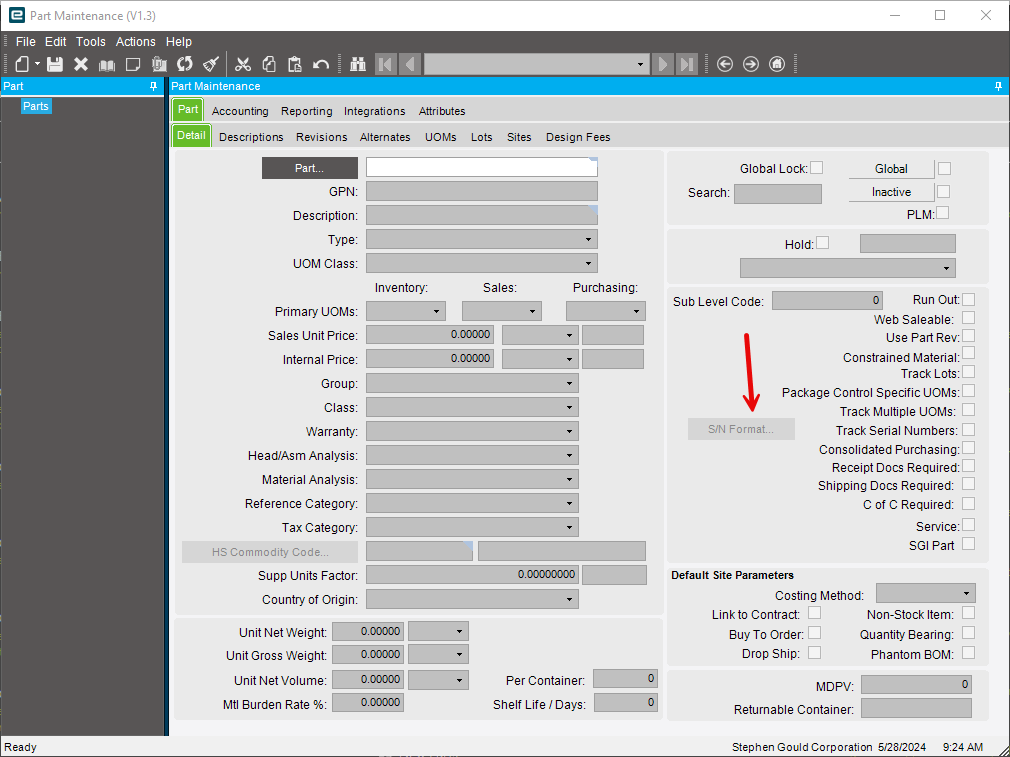

The system only lets you enter serial numbers that meet the correct format. There is no way around this unless you create a special format for specific parts that match the format of your legacy SN. You could do it very dirty by bypassing the business logic but that’s bad practice all around.
Thanks, Jose!
I don’t really want to do it the wrong way.
Do you think there’s a way to view and update the format rules for serial numbers then?
