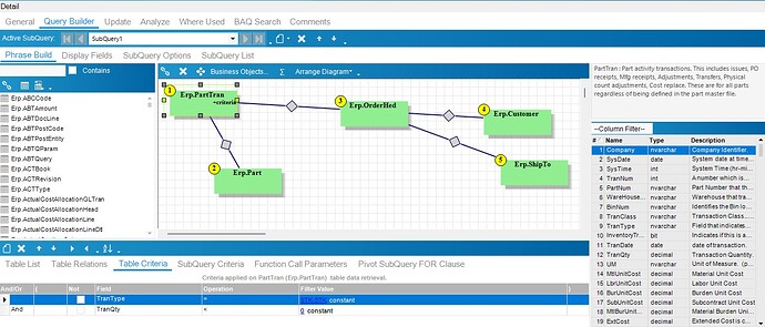

In addition to the above suggestions, you can sort of deduce a pick history despite the fact that the Material Queue record is gone.
You can piece it together via PartTran for the most part using criteria and joins to restrict the records you get. Edit: Assuming your picks are sales order based. The same idea should work with the Transfer Orders as well though.
Thanks Chad, A query based solution is the best option. Currently looking for unique identifier created during the ‘Sent to Picking’ process. The MtlQue.ReleaseForPickingSeq seems to be an option that potentialy identifies a group of records sent out to be picked together. Then once the Pack is started / created, look into PickOrders and MtlQue by above if I can carry it forward onto the PickedOrders and PackDtl. If I can’t am thinking of keeping a UD table at Picking to identify / group the records. Appreciate the ideas. Welcome any others…
