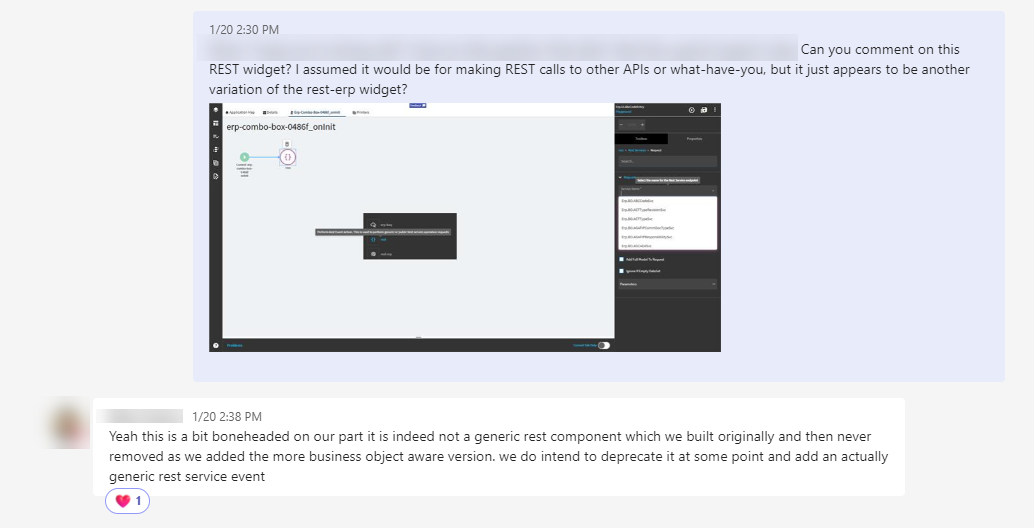

Do you need the SDK to be able to integrate external REST APIs? We have access to an API from one of our suppliers and I was trying to build a connection in Application Studio. I added the “rest” widget to an event and expected to be able to configure it in the Properties. But when I go into the Properties>Rest Services>Request, the Service Name is a drop down. Do I select something that is already in the system or is that where my SDK service would go?
You don’t need the SDK; use a function for your API calls.
Regarding the generic REST widget:
:man_facepalming:t2: :man_facepalming:t2: :man_facepalming:t2:
I didn’t think that through. Many thanks.
