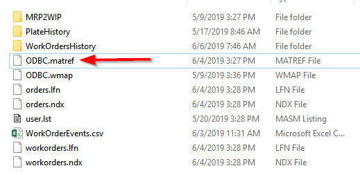

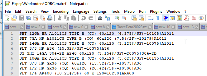

Is that a Unity File? .matref = Material Reference? I wonder if thats just SQLite or XML
I looked in there, but the files don’t show up when I navigate to the location. I’m assuming it’s looking for a valid file extension to work. This program that I am linking into does whatever the hell it wants with file extensions, and I’m assuming it’s hard coded in the program. It’s a simple file.
Some of the information is in a SQL database, which I am already connected to, but this information isn’t. I can build my own cross reference with what I have, but I figured if they were already building the cross reference, why reinvent the wheel. (when the existing wheel sucks is why, apparently in this case)

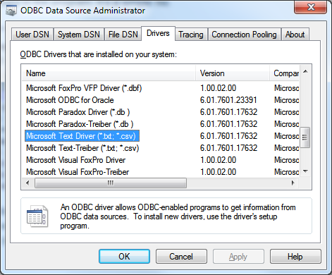

So if you go to your Windows Create a DSN using Excel Driver or I think you can also select a CSV one, once you go to Add Driver (New Wizard). Looks like a csv file, once you can set that up I guess you technically could connect to it with External Data Source referencing your Driver in Connection String.

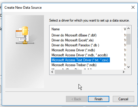

I can’t even add the file as a DSN because the ODBC system doesn’t recognize the file type.
Yeah, it’s looking for .txt or .csv
Looks like you can try to add them, but then it gives you this.

All the file contains is a list of the part material descriptions and list of the system part numbers that the laser program uses. I have access to tables with the Epicor part numbers of the parts being cut and the laser program part numbers, so if I just bring in the laser nesting part numbers with my import already in place, I should be able to build the cross reference off of that. It’s just annoying.

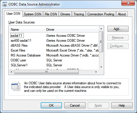

Haven’t read all the posts … But when I setup ODBC I have to use the SysWOW64 version of the ODBC control panel applet at
C:\Windows\SysWOW64\odbcad32.exe
that’s the program in the screen shots.
