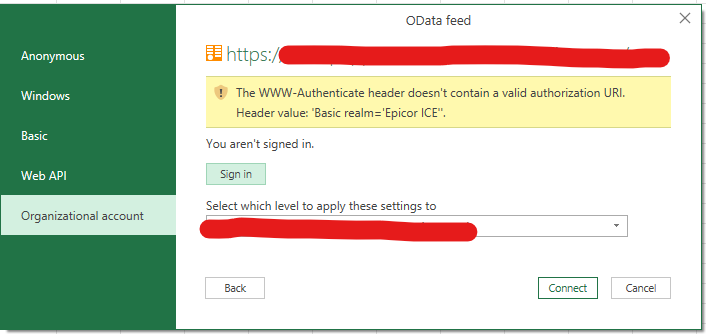

  1. This is where I was stuck. Previously if I tried to use an organizational account, I would get the following error: “The WWW-Authenticate header doesn’t contain a valid authorization URI. Header value: 'Basic realm='Epicor ICE”

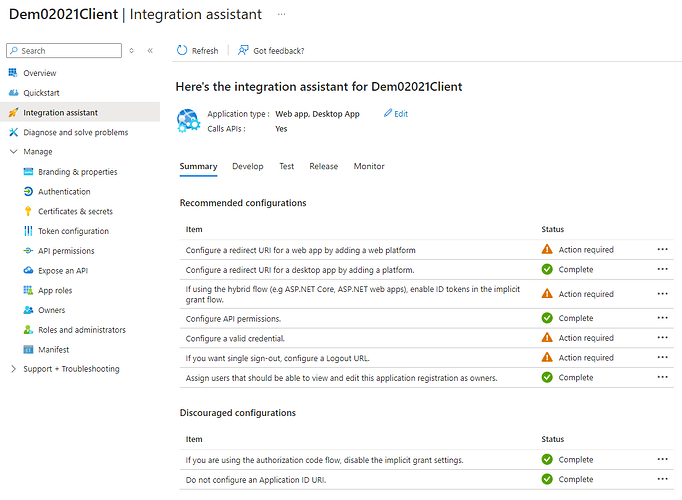

  2. To fix this, go to your Server app registration in Azure portal and add an Application ID URI that matches your server FQDN. The URI value must be a verified domain in Azure. See the following for more information
    Understanding the app manifest (Azure AD Graph format) - Microsoft identity platform | Microsoft Learn

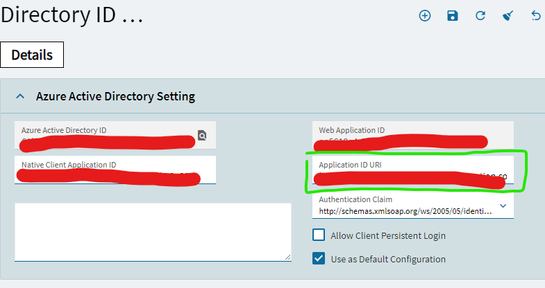

  3. In Azure Active Directory Settings within Kinetic, set the Application ID URI to the same value in Step 4.
  4. Recycle your app pool

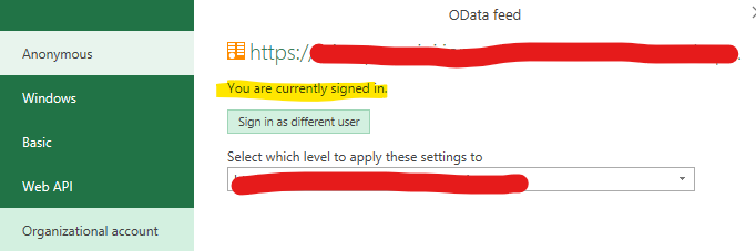

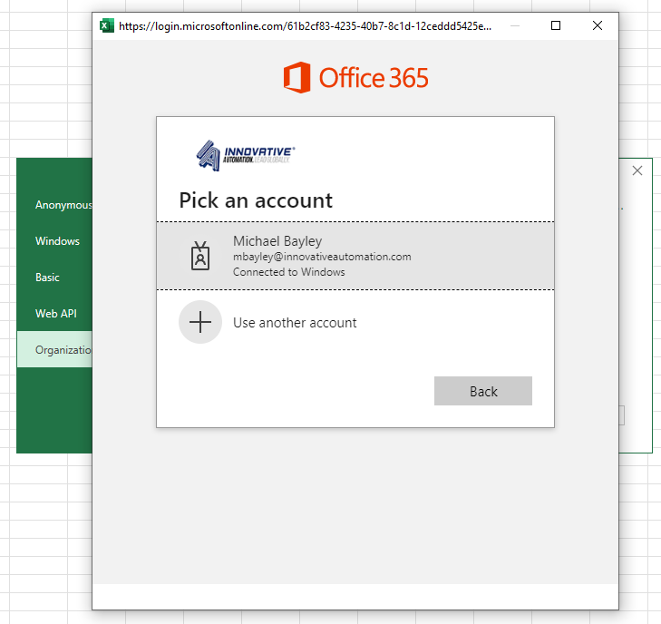

  5. Now when you attempt to sign in from Excel, you should be met with the Microsoft account selector. Awesome.

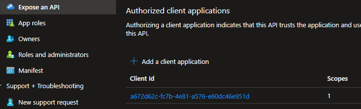

    However, after you authenticate, you will likely get an error “access_denied: AADSTS650057: Invalid resource. The client has requested access to a resource which is not listed in the requested permissions in the client’s application registration. Client app ID: a672d62c-fc7b-4e81-a576-e60dc46e951d(Microsoft Power Query for Excel). Resource value from request: your_server. Resource app ID: your_id. List of valid resources from app registration:”
  6. To fix this, add the Client app ID for Microsoft Power Query for Excel (a672d62c-fc7b-4e81-a576-e60dc46e951d) to the Authorized Client Applications under Expose an API on your app registration. Allow access to the user_impersonation scope. Wait a few minutes for the changes to take effect.

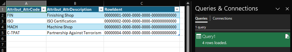

  7. Try to sign in again. Your sign in should be successful :tada:
  8. Go nuts with your data source within Excel

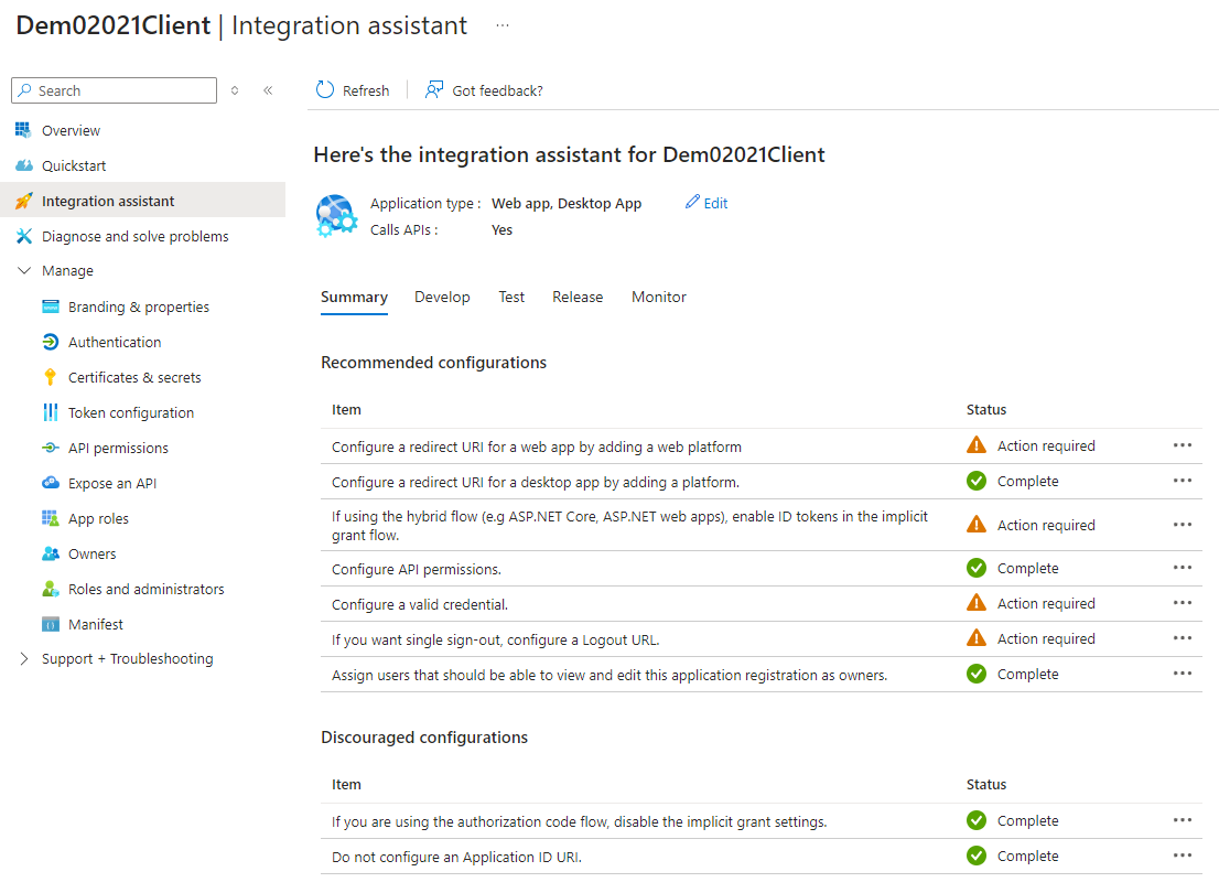

I also see that Entra has a nice utility to check your security settings:
