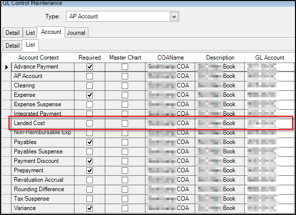

You will need to set up a couple of additional GL accounts.
In your AP control accounts “Landed Cost”
And depending on your setup
Product Group COS Material Burden, WIP Material Burden
