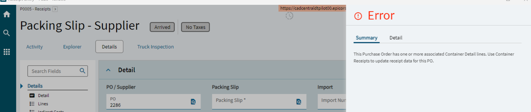

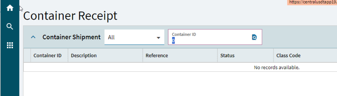

I can build a container in Kinetic but the form to receive it is not there
I also do not see a way in regular receipt entry in Kinetic to receive a receipt.
Does this impact anyone else?
Epicor keeps sending emails. We notice that you are still using classic which is going away… Not a big help haha.
And you can’t receive a container in regular receipt entry.

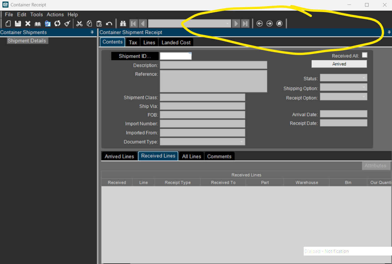

Does it ever come back? I have been checking the classic form for a Kinetic link for the last 3 upgrades and it was not there. I had chalked it up to Epicor not bothering to create the functionality - like with Inspection Plans.

You can clear personalizations or set your preferences to kinetic.
Again thankyou!
I didn’t have any - no surprise I tend not to use them in Classic.
Still did not show up. Weird.

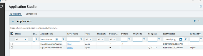

But now I have a Layer for Container Receipts - and it’s working. Thankyou.
I found the base application by filtering the application list and put a layer on it.
On the off chance that anyone else runs into this issue the application ID is Erp.UI.ContainerReceipts
