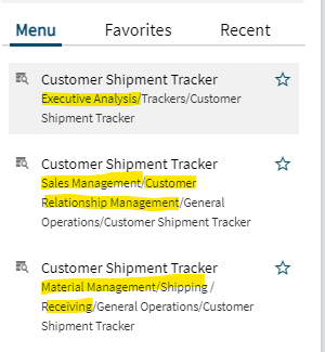

But there are (3) Customer Shipment Trackers.

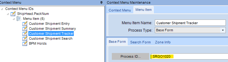

The Context Menu (in my system) is pointing at SRGO1020

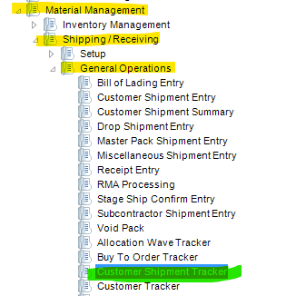

SRGO1020 is the Customer Shipment Tracker found in Material Management > Shipping/Receiving… which your Sales & Customer Service group apparently can’t get to.
THEY have access to the Customer Shipment Tracker under Sales Management > CRM… which is Menu ID CRMG1180
One solution is to create a NEW Context Menu called “Customer Shipment Tracker (CRM)”… and point that one to Process ID CRMG1180. Then your CS team should be able to get through. You’ll just have to live with (2) Customer Shipment Tracker options in the context menu.

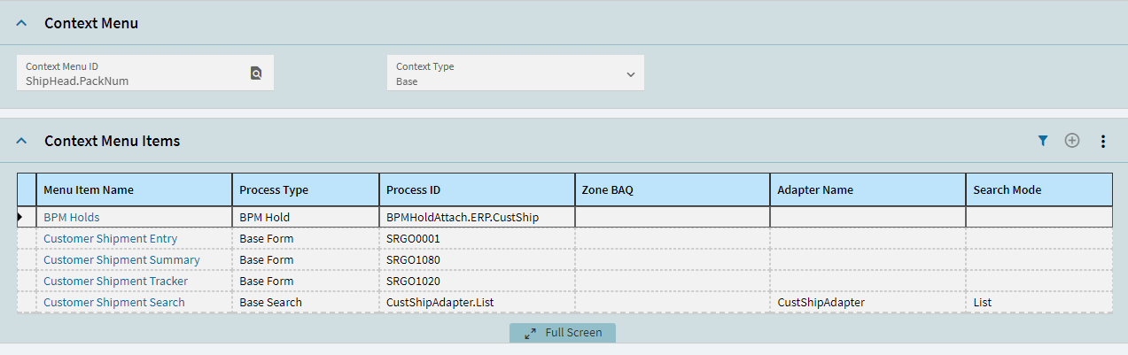

I can access the Context Menu Maintenance, but the only thing I can find related to customer shipment tracker is this:

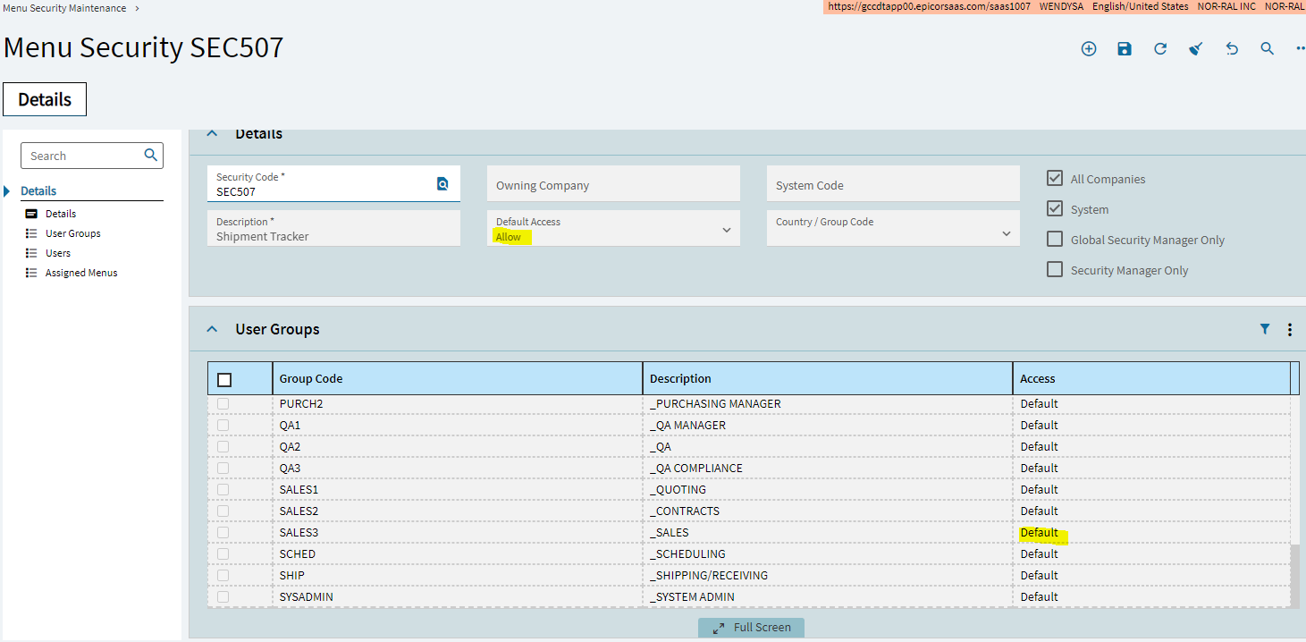

Our Sales/Customer Group along with all other groups has access to SRGO1020 (Security ID SEC507) as shown below so I don’t understand why they would get an error saying menu ID Erp.UI.CustomerShipmentEntry.

So they have (menu security) that allows them to access that menu… but do they have access to all the parent menus where that Customer Shipment Tracker is?
Can they get into Material Management? Can they get into Shipping/Receiving?
If not, then, even though they have security to open Customer Shipment Tracker… they can’t get there.

The security setup for SRGO1020 is already set to Allow Access to All User/Groups so the individual user ID is already in the Allow Access list.

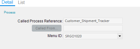

When you put the form into developer mode (in classic) and you open the context menu you will get a popup like
You can go into Process Calling Maintenance and take a look and see if there is something wrong with it. Or you have a custom process calling entry that is configured for Erp.UI.SalesOrderTracker as the calling App that has the incorrect menuid
By default the standard Process calling setup for SRGO1020 has no value in the called from field which means “Use this menu for any apps that call the Customer Shipment tracker”
Here is an example of the standard
If you don’t have a custom Process calling then you may want to try creating a new custom one to override the standard trying blank in the Called from or adding in Erp.UI.SalesOrderTracker… By the way the case matters if I recall.
