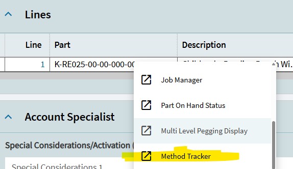

I must be missing something simple. We’ve done a lot with context menus over the past year. We would like to add Method Tracker to the Context Menu of Part.PartNum
I’ve added the Menu Item Name to the Method Tracker with the Correct Process ID, but it simply takes us to the Method Tracker, without going to the exact right-clicked part. In other words, it goes to the Method Tracker Dashboard.
Any help?
Method tracker is in the context menu of revision, not part.
Wow; that makes total sense! Yes, it does work as a context menu on the Revision, you can’t go to the method when it doesn’t know which Revision… duh!
Thanks for the quick reply!
