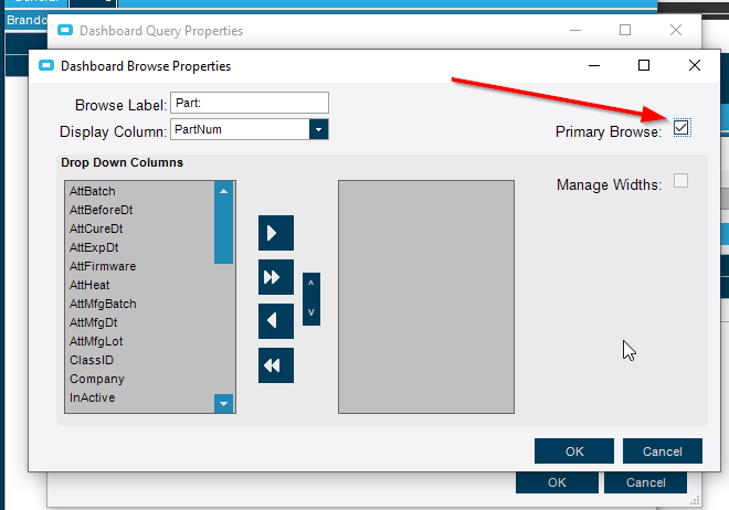

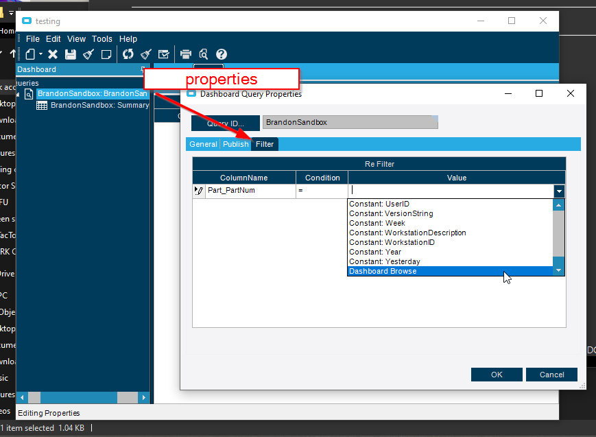

This only works with the filter on the query (not filtering on the grid property) and only on some fields. Usually the primary ones like part etc. If it works, at the bottom of the list will be dashboard browse, otherwise you’re mostly out of luck.
