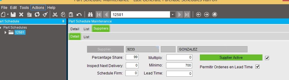

little supplier part schedule custom configurations (allow to set multiple and minimunqty for example to supplier and not tu part)

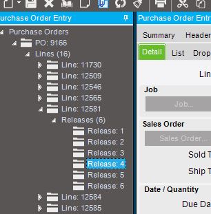

Actual PO Status (have a release with 1000 on status OPEN)
DB from PO Detail (have 0 cause on this record we alreally have the error… must be 3000)
After we run the process, here are the results will impact:
- 9166-5-2 will go to receiveqty (100)
- 9166-5-3 will be deleted
- 9166-5-3 (new) will be added, qty 1000 and duedate 23/05/2019
- 9166-5-4 will be deleted
- 9166-5-4 (new) will be added, qty 1000 and duedate 24/05/2019
- 9166-5-5 (new) will be added, qty 1000 and duedate 13/06/2019
- 9166-5-6 (new) will be added, qty 1000 and duedate 04/07/2019
