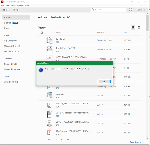

After getting a successful response back from the UploadFile() method, I am able use the FileExists() method within Ice.BO.AttachmentSvc, to which I get a true value in the response if using the correct fileName, parentTable, docTypeID. But when I search for the file on the server, it can’t be found anywhere.
Otherwise, I have the rest of the process down. I am able to get the attachment to show up in the Opportunity/Quote Entry dashboard by passing the correct values in both the XFileRef() method and the QuoteHedAttaches() method in the Erp.BO.QuoteSvc service.
Only when going to view it, it first asks what app do I want to use to view it (on PDF attachments that can actually be viewed, Adobe AR auto opens). When selecting Adobe AR, it opens up to this:
Could it be that the file is simply hidden or locked?

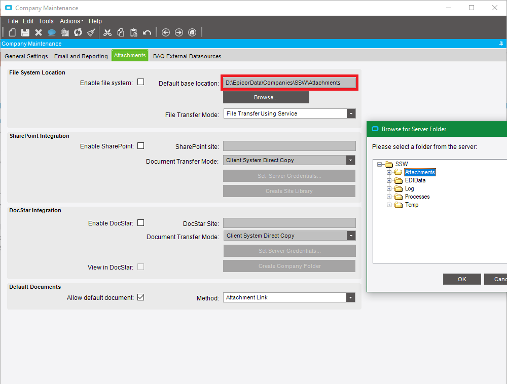

Did you set specific folder for file attachments in company maintenance form?
Also is file transfer using service selected there in company maintenance form?
Yes, I tried a few things on that form, but was unsuccessful. However, I could have been doing something wrong. :man_shrugging:
I believe adding a value to the “Default base location” input (after checking “Enable file system”) acted similar to trying to manipulate the file location in the Document Type Maintenance forms’ Base URL field. It would still put the CompanyID (‘SSW’ in my case) after the base URL, and before the file name.
‘File Transfer Using Service’ is also selected for the File Transfer Mode.

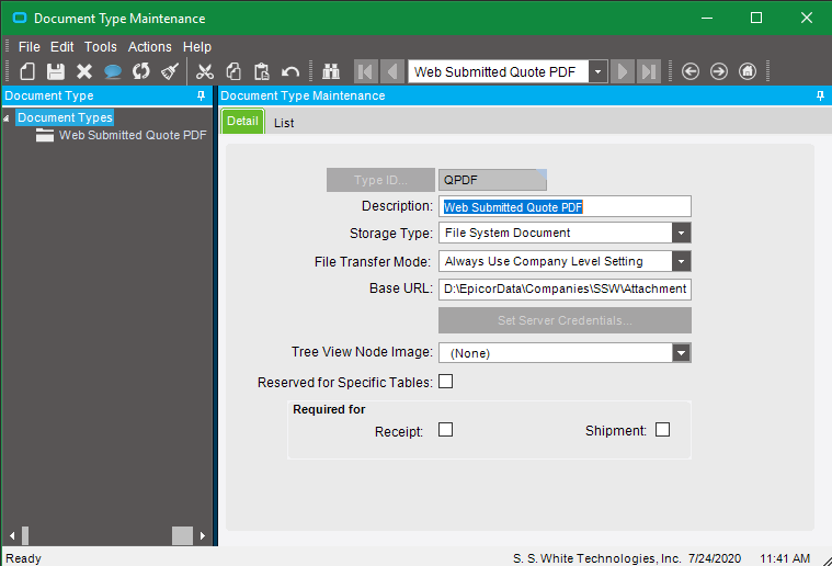

Trying to manipulate where the UploadFile() method was as simple as using a Document Type. My first mistake was passing the wrong baseURL. I was trying to pass the server location e.g. \erp-app\EpicorData\Companies\SSW as the baseURL. I realized I was using the wrong file path when I used this:
It makes sense the actual drive letter in the file path works, given it’s on the application level.
Setting up a Document Type like this:
Allowed me to call the UploadFile() file in this manner with the expected results:
“docTypeID”: “QPDF”,
"parentTable": “<%-Customer Name-%>”,
“fileName”: “testingQuoteThiss.pdf”,
“data”:
I would also like to note that the parentTable does not have to match up with any table name within Epicor’s DB. This parentTable field just adds another file name (to the right of the baseURL) to the structure of the baseURL set in the Doc Type.
For general understanding of this whole post, this UploadFile() method is being used to allow a web app to use REST calls to take a submitted PDF (Purchase Order) and attach it to a quote. A problem arose if not using the parentTable field: all submitted PDFs will go to this path - D:\EpicorData\Companies\SSW\Attachments. What if two PDFs with the same file name were submitted by different customers? One file would be replaced and the other lost.
The end solution: passing the Customer Name from the data on the client side to the rest call, using that Customer Name for the parentTable field. Now a new folder is created for each Customer Name, adding another layer of folders based on Customer Name.
