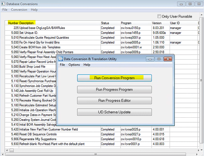

In epicor 9 you see the list and what they do (description) using Epicor Admin Tools > Run Conversion Program.

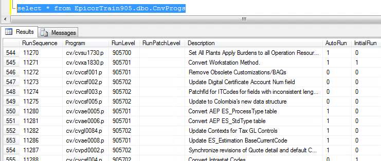

or by querying the database:
select * from EpicorTrain905.dbo.CnvProgs

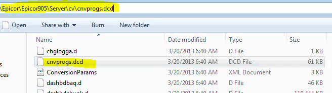

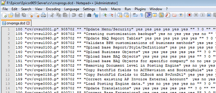

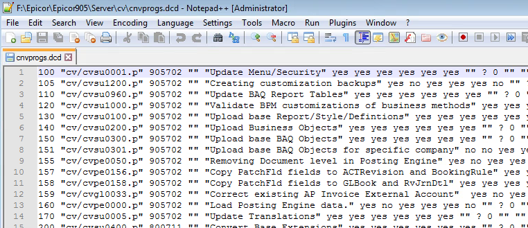

Or by looking at the content of the cnvprogs.dcd file located on the epicor server folder.

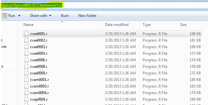

Unfortunately you cannot see what they do because Epicor only delivers such programs in binary format (.r) and not in source code format (.p).

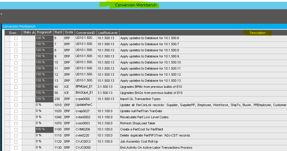

In Epicor 10.x you do it by using the Conversion Workbench.

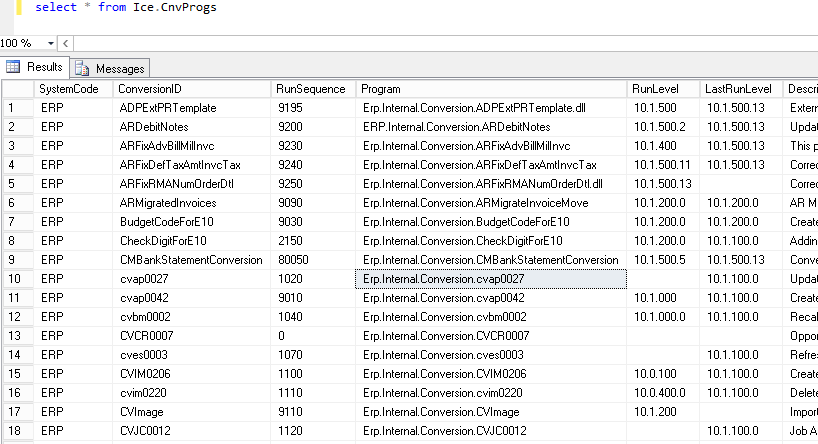

or again by querying the database.
select * from Ice.CnvProgs

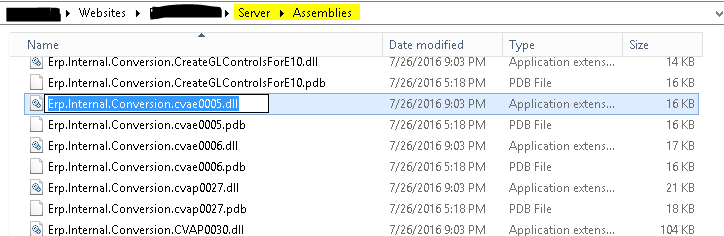

or looking for Erp.Internal.Conversion,dll under Server\Assemblies
Here you have more luck. You can decompile those “.dll” assemblies to know exactly “what they really do”.
