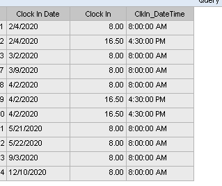

If it is in a BAQ, you could make it a calculated field of type datetime, and use a formula like:
dateadd(second, LaborDtl.ClockinTime*3600, convert(datetime, LaborDtl.ClockInDate))
Then in the format filed select {longtime}
You’ll get

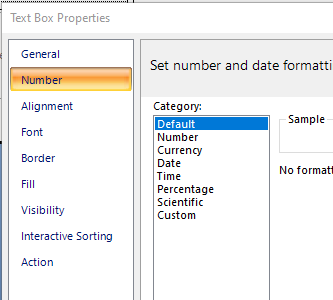

Have you tried the Text Box Properties? Just add the field to a text box (no convert) and right click.
That was what you would use in a BAQ (which uses SQL syntax).
