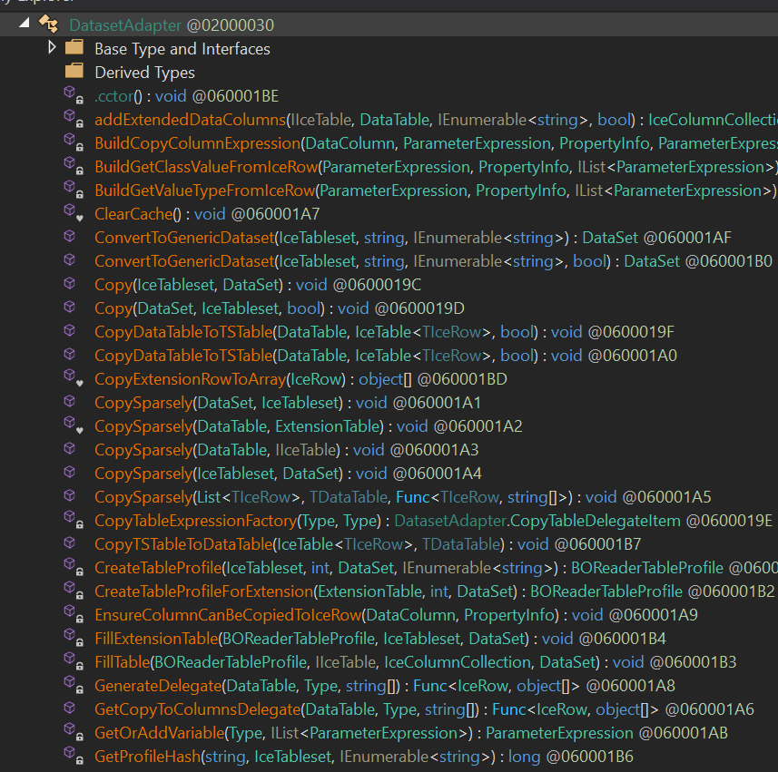

Not sure why you want dataset there, but for example, look into Ice.DatasetAdapter.ConvertToGenericDataset from Epicor.ServiceModel assembly.
Example:
DataSet ds = new DataSet();
ds= DatasetAdapter.ConvertToGenericDataset(this.resultHolder.Original, "", null, true);
@Olga , the reason why I am trying to do this is so I will have OrderDtl data available for a Data Directive on the OrderHed table. I may be doing things incorrectly as I am a hack. :laughing: :rofl: :upside_down_face: But this is the best way that I could think of as I am working in a multi-tenant environment.
@hkeric.wci, thanks for the screenshot and example :+1:
Where is this screenshot from?
Decompiler… dnspy, dotpeek(my choice). :wink:
Ok. Which file should I get decompiled and where it should be?
It can be found within your client folder. Epicor.ServiceModel.dll
