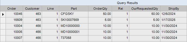

I have a table like this with repeating order and order line level data with each order release row.
I’d like to format the JSON string where it shows multiple nested levels instead of just repeating lines like this:

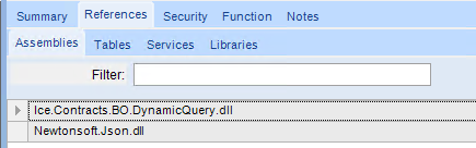

The EFx requires:
And

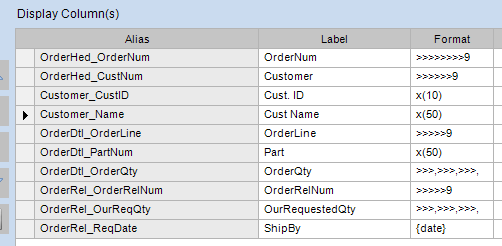

The BAQ:

    string keyOrder = "OrderHed_OrderNum"; // related fields must be grouped between OrderHed_OrderNum and OrderDtl_OrderLine in the table
    string keyLine = "OrderDtl_OrderLine"; // related fields must be grouped between OrderDtl_OrderLine and OrderRel_OrderRelNum in the table
    string keyRelease = "OrderRel_OrderRelNum"; // related fields must follow rderRel_OrderRelNum

This should work on POs, too, by changing OrderHed_OrderNum to POHead.PONum, etc. Or any three-level set of data in the BAQ results table.
Note that fields related to a level should be located between the two level keys (i.e. OrderNum and OrderLine).
