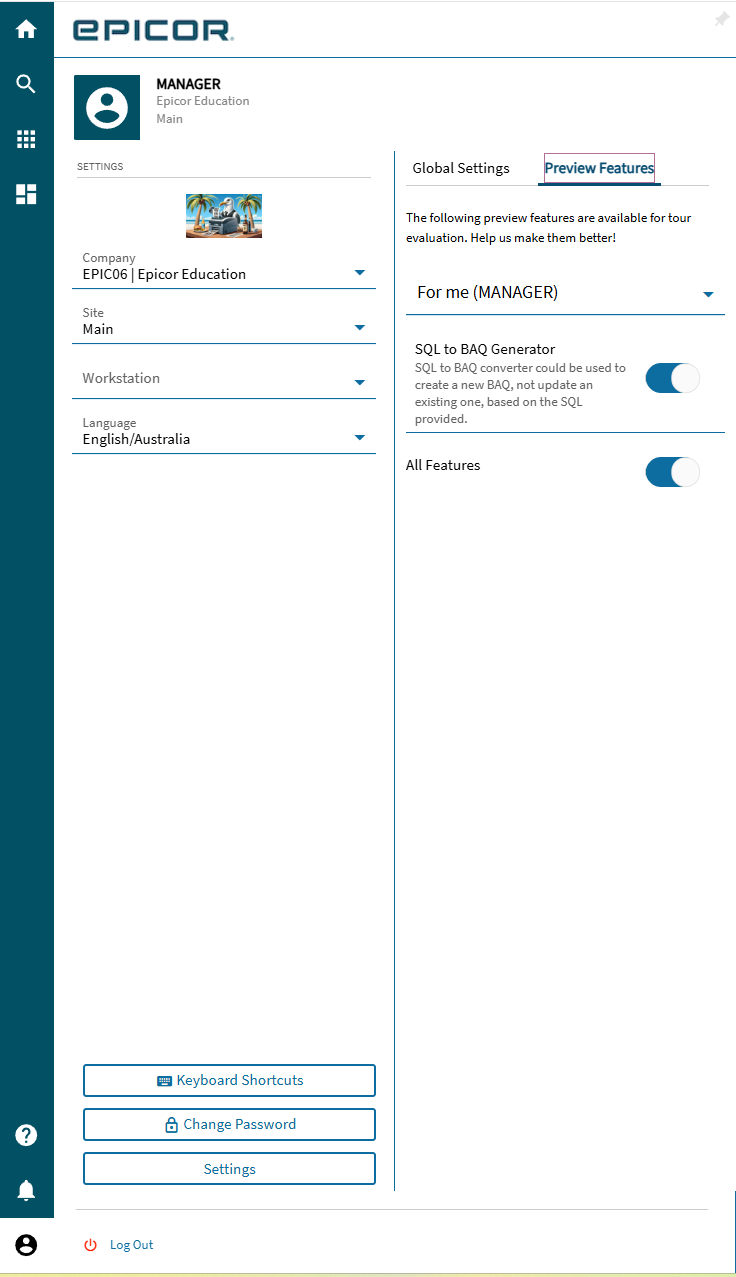

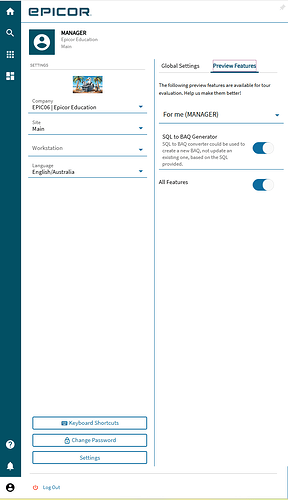

Needs to be set in your Preview Features I should say. Which is under your settings.
You can only activate this from the Browser Homepage view.
Awesome! Thank you Hally.

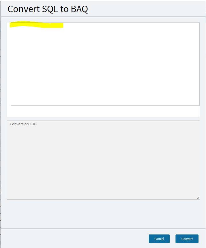

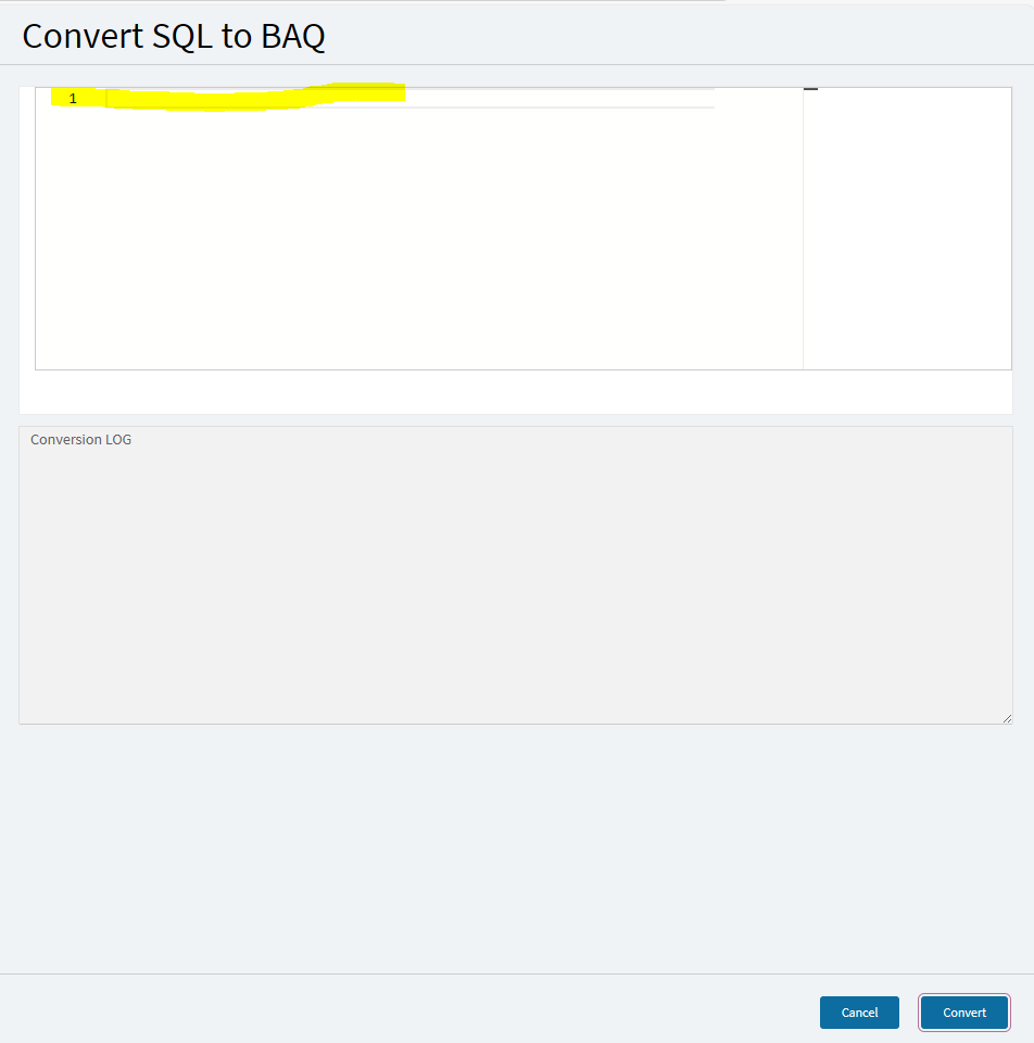

It appears you need to be in the “Kinetic Browser” to both Activate the feature and use it. After activating it in Browser I went back to the Smart Client to use it. It was no longer greyed out, however when I open it and tried to type/paste in SQL nothing happened.
Smart Client
Browser
I believe it was working in the client as well as the browser. It typically works for simple queries but I found doing anything with CTEs or Unions I found those to fail almost always.
I’ve never run into the issue you’re experiencing though where pasting/typing doesn’t work.
